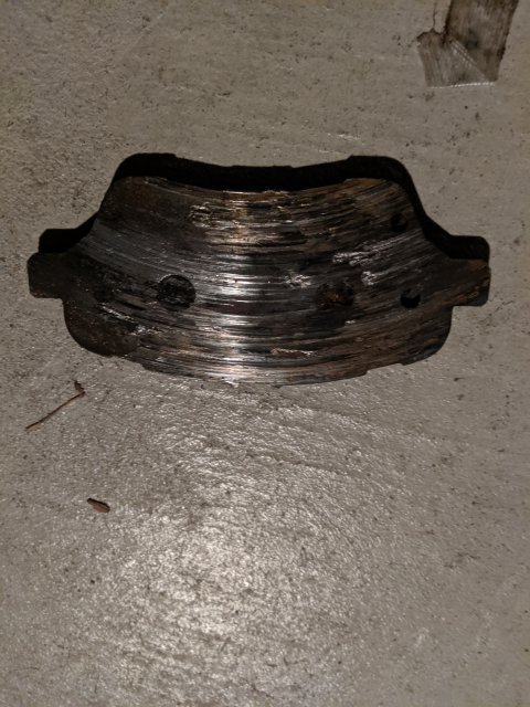

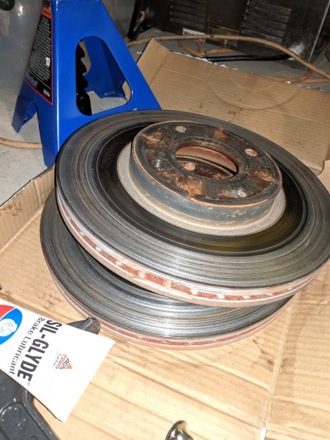

Hey everyone so I went to my first track day with my 5k mile FiST Saturday at GingerMan Raceway and it was honestly the most fun I've had in a while! The only problem is that by the time my last session was over I noticed a lot of vibration and squeaking when I pressed on the brakes. When I got home, I found my rotors we're completely gouged and destroyed. IMG_20190611_223945.jpg
And here's what my pads look like:

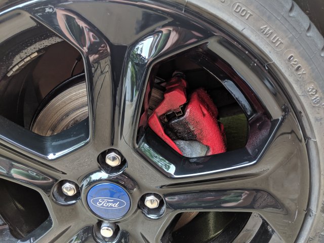

MVIMG_20190611_223846.jpg Also, the powder coat was burned off the front of the calipers:
After this I installed some new centric rotors and hawk pads and I'm planning on getting some track only pads.
I'm honestly shocked by how fast the stock pads wore down in track conditions! So I need a bit of help, what should I do to prevent something like this from happening again? Am I braking too hard or we're the pads just not meant to take anywhere near the kind of heat 4 session on the track can put through them?

Were those the factory summer, or all season pad?
Also there is a lot to be said for learing how to use as little brake as possible with these cars. Maybe its from my long time of racing with less than 150 hp in a similar sized car, but you really shouldnt be on the brakes that much. Even ecs all the way off torque vectoring is still active if im remembering right. Only solution there is to work on being super smooth with inputs to not upset the car.
They were the all season pads so that's probably why they wore down so fast. I was definitely having fun finding the limits of the car and was not the smoothest driver on the track. I think focusing on being smooth and getting the line perfectly would definitely help instead of just chucking it around corners.

I think torque vectoring might have been the issue as my rear pads still have some life left in them. I had a heavy right foot out of turns; especially the sweeping turns where I noticed a lot of under-steer. I think I may keep the rear rotors and pads stock for now and get some front track pads from carbotech, high temp brake fluid and upgrade my tires to firestone trackhawk indy 500s instead of my stock pilot sport a/s. Thoughts?
