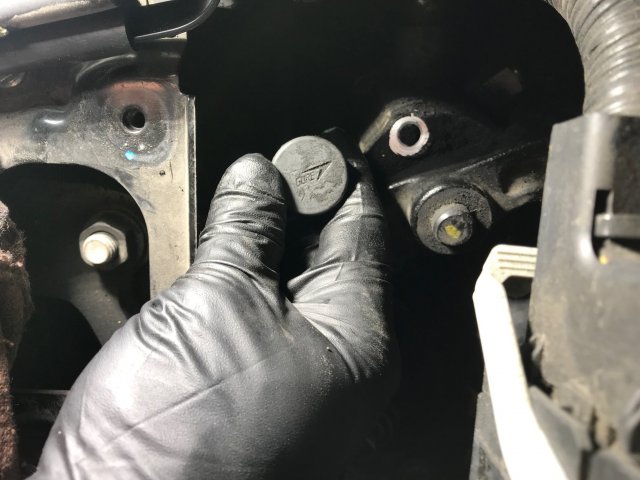

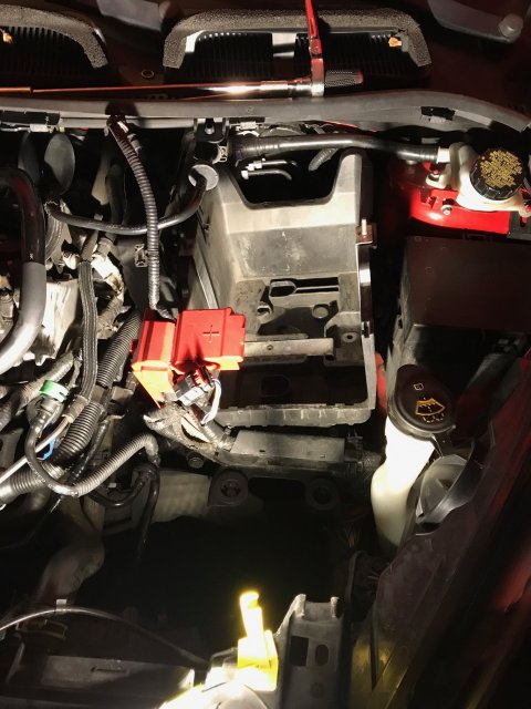

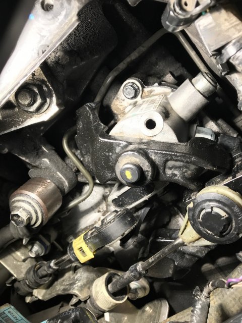

Guys I need some help! I found the oil leak, I removed the airbox, the battery and the battery tray, it looks like transmission or gearbox fluid is coming out from where the shift tower mates the gear box, is this tower removeable? has anybody done it? also my gearbox vent is broken, looked on Ebay and everywhere for a new one, nobody makes one? I removed the shifter cables and removed both bolts that holds the shifter tower to the gear box, but did not want to forced it out, or having a billion pieces flying off. any suggestions?

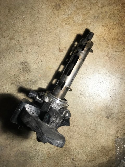

Oil leak seems to be repaired, removed the shifting tower, replaced the o-ring, also used 1207B Ducati bond at the mating surfaces. Exhausted and ready to go to sleep.

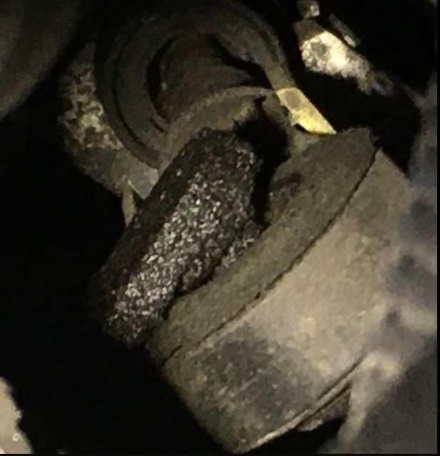

Hmmm I wonder if I have similar problem, maybe to a lesser extent... here's what I see from the top without removing anything, that's one of the shifter levers. Nothing's leaking on the ground, but the top of the gearbox is definitely covered with thin dark layer of oil, it seems. Car's 6 years old, could it have vented that much over the years?

If anything it may have been the broken vent that caused it. I think the vent on the trans uses Gore-Tex, which is a type of membrane that is water-proof but still breathable. Possible that somehow it failed and could no longer breathe, allowing pressure to build with heat cycles, and in turn the pressure caused the seal on the shift tower to fail and become the "new vent."
This is just speculation though. I would have expected the axle seals to present issues before the shift tower.
The shift tower have an o-ring,I believe that in 70k miles the o-ring flatten out allowing fluid to zip out, the o-ring does not get sold separate from the shift tower, I have a box full of o-rings, was able to match one, and during installation used some 1207B sealant in the mating surfaces between the shift tower and the gear box, I cleaned all the fluid, drove the car about 120 miles and my garage is totally spotless under the car.
