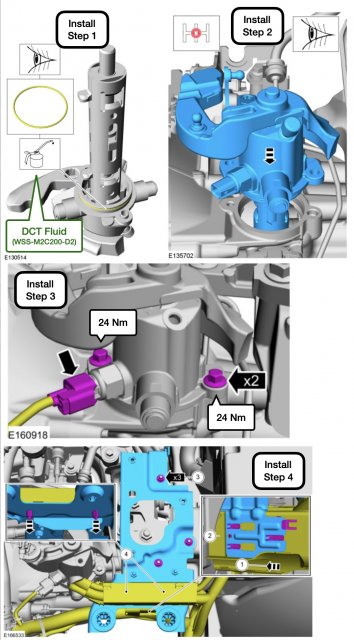

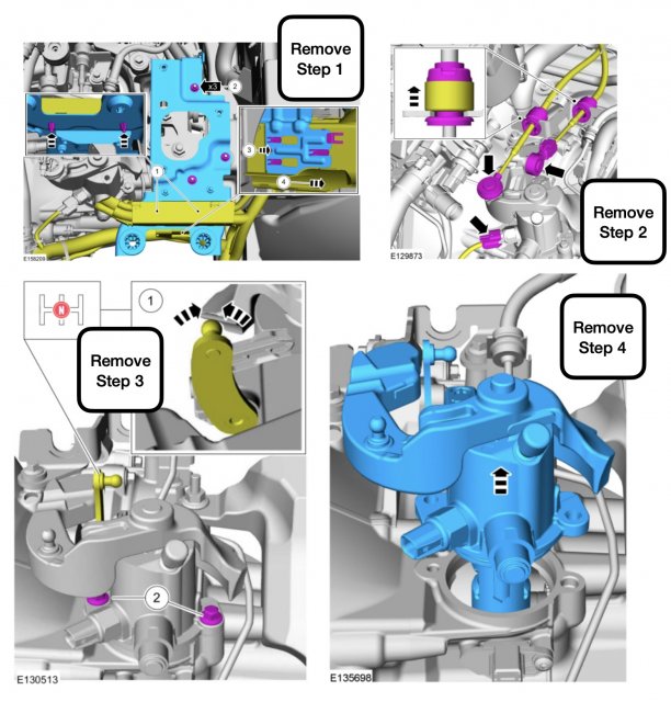

It looks from the service manual there are just those two bolts securing the selector mechanism assembly to the transmission housing, and then it just lifts straight up:
The O-ring is supposed to be lubricated with transmission fluid and is meant to be reused if not damanged according to the service manual. Install illustrations:

I've never done it myself, so I'm not sure. I just found that section of the shop manual and annotated it to share here. @bdarrach might be able to add more from experience.
