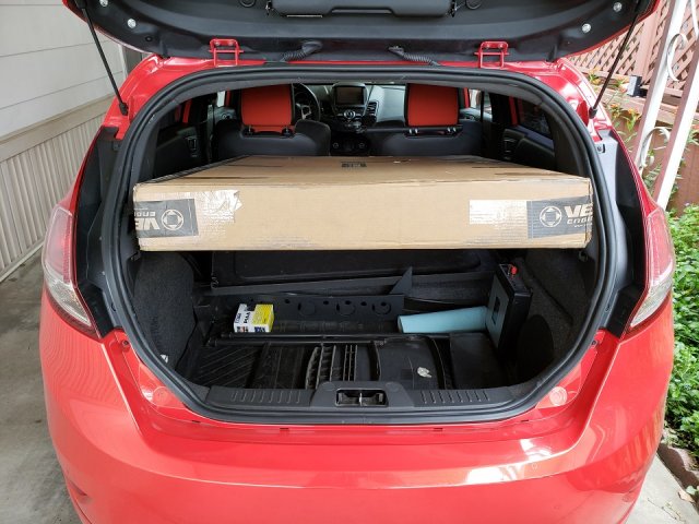

Mine has arrived.
Now the fun begins.
I will start by making a pattern out of foam core board that I can start cutting on.
This project is going to take a while to complete.

#77
Good thing it is mounting under the car.
Because it almost does not fit in the car.
