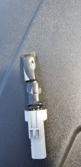

Thread Starter #9
20200613_101441.jpg Well this looks suspect.
Spork1569
#9777
689
533
Did you do the CEL defender with that as well?
No it plugs right it but for some reason turbosmart didn't put the indicator telling you which way to insert the solenoid, so double checking that it's the correct way may get rid of it. I tried both directions and neither worked sadly.
