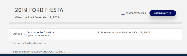

corrosion perforation is 5yrs/unlimited warranty so that service rep is correct
edit: i bought my Fiesta ST new in late 2019 so i would be covered. for those who bought their FiSTs before June 2018 you might be SOL.
