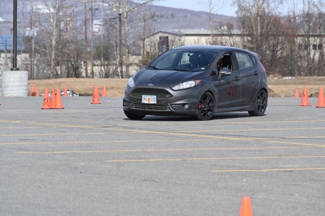

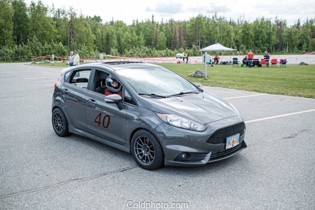

It was pretty low- it was new in the first picture in this thread, here is a little later that summer. The 15" wheels and tires do leave a bigger gap in the arches than it does with the stock 17s, and I think it settled a smidge as well.
One more question from me, did this setup rub under hard cornering at all?
Pablo Pistoffo
404
575
Anchorage
Thread Starter #27
It has been a couple years since I got the coilovers, so I'm going off memory, but there was just some very slight rubbing if I'd hit a bump mid corner (we have horrible parking lots here).
The bigger issue for me was scraping my lower two point brace on speed bumps- somebody decided to put some on the entrance to some of the roundabouts in town.
