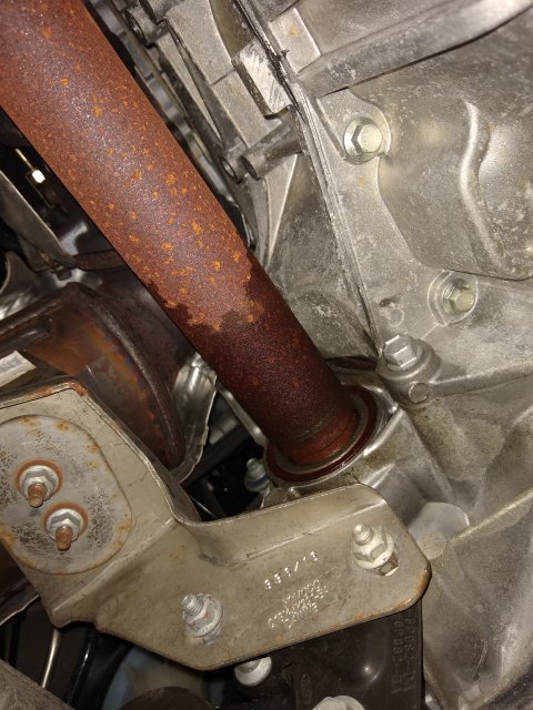

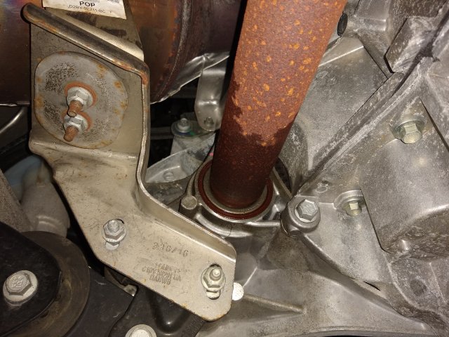

Update, mine looks even worse than the pictures above. I need to schedule to take it in, my RMM is soaked in gear oil.

This was replaced while the dealer had it. Clearly didnt do a good job.
