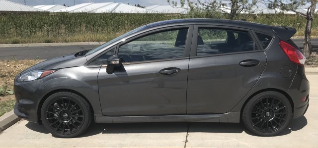

I just did soft and sticky cheap UHP all season 215/40/17 tires with Eibach springs on '17+ OEM shocks... I like it. Fender gap is gone and only very, very minor scraping on inclines. Also like the ride now, not as soft as I feared at all and lowering center of gravity still helps overall with handling AND putting the power down if you have a high torque tune. However, steering response is now slightly less immediate, but also feels like you have more subtle control too, if that makes sense. Definitely very happy overall that I did them!
https://photos.app.goo.gl/wFFrU2vmXRb4MvgQ7
