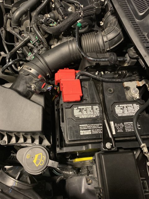

Personally, I would change one step.
Rather than disconnecting the PCM, I would just unbolt it from the battery box and leave the PCM in the car.
Less chance of screwing up a pin in those large connectors.
Smart Man. I would never mess with a PCM connection unless 100% absolutely necessary.

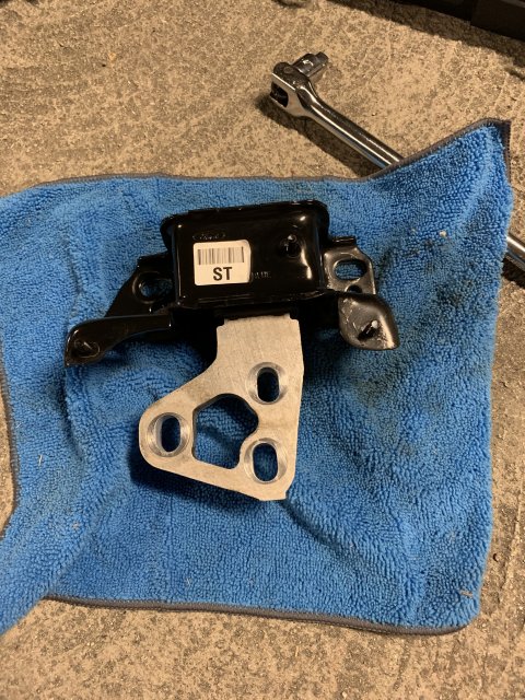

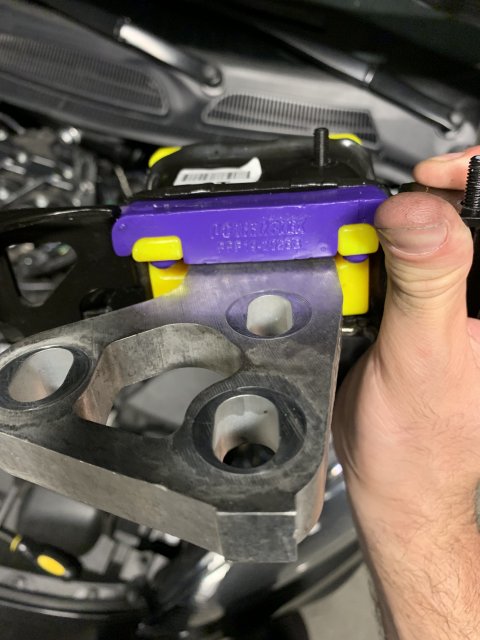

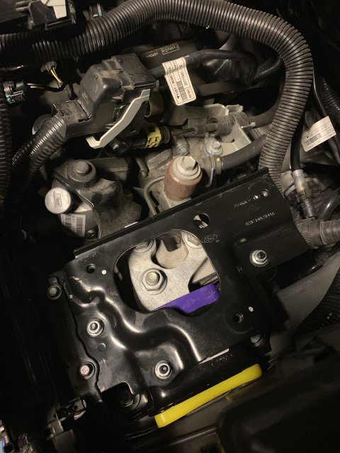

Successful install.
Passenger Side:
I will say, I had to redo the passenger side because I rushed and forgot to replace the old bolt with the new arp bolt from Whoosh... Also, not torquing the bolt town before installation caused for the bushing to sink into the gaps in the top of the mount but since I had to unmount the top bracket which connects to the deck I just kept the engine jacked, removed the bracket, realigned the bushing, put the bracket back on, tightened the bolts down on to the engine block and then pulled the engine towards me while threading the new bolt in. Once the car was on the ground the bushing went into place and was perfectly flat.

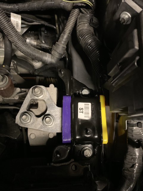

Driver Side:

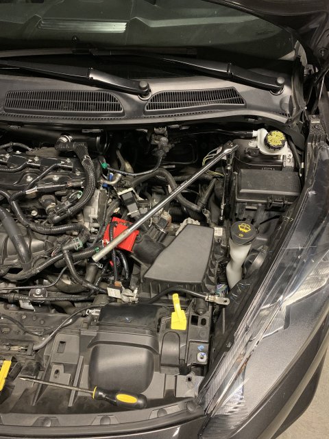

I removed everything including the PCM/ECU connectors, not a big deal if you are careful and know what your doing. My only snag was the bolts mounted to the frame of the car.... took many attempts with a breaker bar, a breaker bar extension... then impact... then penetrating oil to get them off.
All that to say, everything feels great, really happy with the shifting feel, less slopy acceleration etc..

I got the driver side mount done today after putting it off a couple weeks. Definitely a much bigger job than the passenger side. You don’t have to take out the headlight just a million other things to get to that mount. Everything went back as it came out, no codes, and no problems. +1 on the breaker bar for the frame bolts. Torque steer is further eliminated down to almost none. I also had to fix the pineapple slide that slid down inside the mount.
