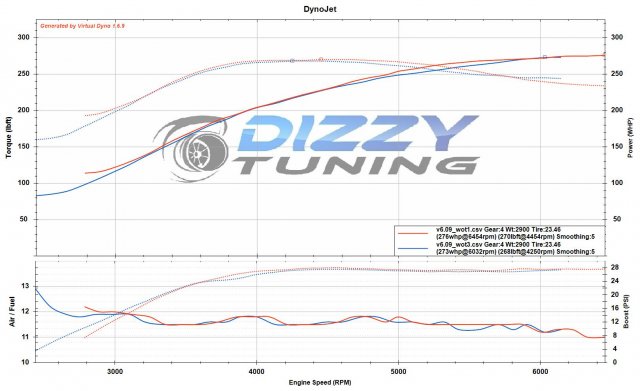

This seems really low for 28psi. S280 is making more with 28psi tapering to 24psi past 5800 before my aux was turned on. What Kind of timing were running. The AFR doesnt seem fat.
