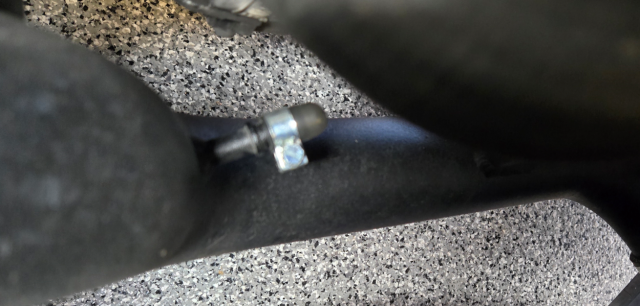

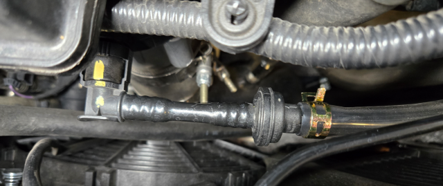

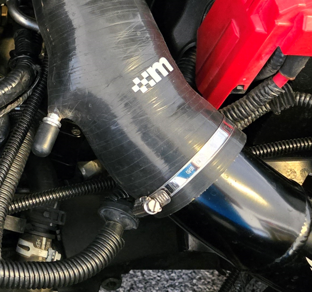

Should do a DIY with all parts used Etc* [driving]
I posted some pictures in my build thread but not sure there's enough content to do a DIY. It's basically:
3/8"silicon hose
metal tubing by the firewall -> purge valve -> check valve -> intake manifold
firewall to purge valve (this is where I spliced in the fuel filter later)
purge valve to check valve to intake manifold
I got rid of the other tubing associated with the venturi effect while under boost. My reasoning is that fuel utilization should go up while under boost and thus the fuel tank should not be under pressure at that time. Haven't had any issues since I did the mod a couple of months ago but it will be easy enough to add the other tubing back if needed.
Capped the cold-side pipe and induction hose.

Thank you! Seems simple enough without spending several hundred dollars.

Well, I'm dealing with the purge valve issue and doing the research about the best way to go about solving the problem. I really like Bull Run's approach.
Can anyone else corroborate that the intake hose and the cold side intercooler pipe can be capped off and that part of the harness eliminated without causing a CEL or other issues? We don't have visual inspections here in GA and if that works it would be a wonderful and inexpensive solution.
