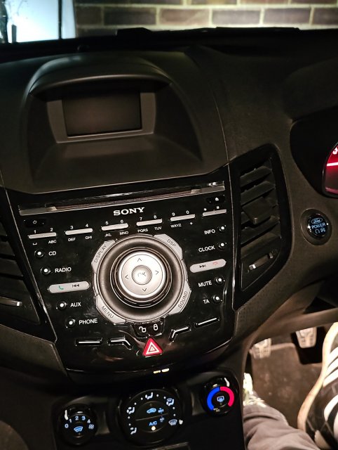

My Fiesta ST2 2017 radio and display is also playing up
Screen does not turn on when I get into car or when I start car. Fuses are OK
Unplugged head unit behind the fascia dashboard, Unplugged and plugged back in and can hear the cd Spin up so it's getting power. Put in another head unit and hear it spin up as it get power but radio and display screen is blank and unresponsive.
