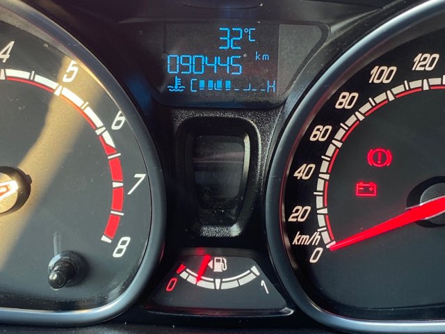

Yesterday I ran out of gas completely, but the gas gauge was still at 1/4 and I had 160km (100miles) range left. Usually the range would throw me off, but I was driving very "economically" (read: slow as hell) and I didn't think nothing of it.
Filled it up and it now shows 850km (~530miles) range left, which is way too much, so obviously something is wrong with the sender unit. I've only had the car for two months so is this a common issue (like blend door actuators) or am I just unlucky? And you can't buy just the fuel sender unit, you have to buy the whole fuel pump, is that correct? OEM only or have you had any luck with cheaper options?

I was being paranoid and filling the tank at 1/2 for the whole time after the incident and everything is working fine. The amount of fuel in the tank is consistent with whats on the gauge cluster, range has gone back to normal and it's working perfectly.
That weekend I was in Croatia during a heatwave and the car was sitting in 45c (110F+) sun for a few days, so my best guess is that the tank being nearly empty and the heat messed with the sensor somehow. The next day after I got home and my car was sitting in its cold garage, everything went back to normal.
