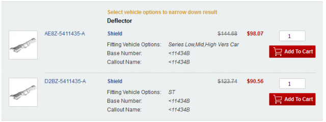

Mine sagged upon return from warranty work back in 2017 for a water intrusion issue that I ended up fixing myself.
Just now wore through.
Unfortunately, I didn't get a good shot of where the rip was located on the new liner so I am not entirely sure whether there is an actual mounting point there or if it was just a general rip in the liner but I added the pictures either way if you'd like to take a look.
I think it's more likely that the mounting point I have highlighted loosened up since I don't really see a mounting spot on the new one where the rip is located on the old one.
The prices were listed on the invoice as "Warranty" so I don't have priced but here are the parts list:
Qty | Part # | Description
1 | AE8Z-54278B51-A | Filler - Quart
2 | -W703505-S439 | Clip
2 | -W703507-S300 | Clip
1 | -W701054-S300 | Fastener
Thanks for the part numbers.
They're not currently available on Amazon if anyone is looking.
Given that other parts were flat out missing from the warranty work, I'm wondering what these are?
https://www.fordpartsgiant.com/part...a/body_and_paint/splash_and_heat_shields.html
Any other parts I should look for?
Thanks.
