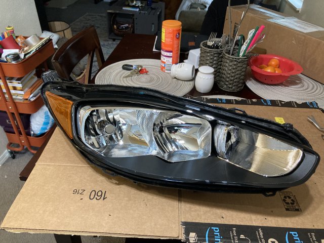

Which method will you be using to open them up, heat gun or oven? Because these headlights don’t fit in most peoples ovens lol.
This part is gonna be the most nerve wracking for me.. nothing like hacking up $200 worth of perfectly good headlights 😅
They fit in my oven. :)
I have never done any headlight with a heat gun....
235 for 18-22 minutes has always opened headlights for me. It may take a few trips back and forth, but it gets the job done.
The heat gun method maybe be some peoples go too, but I never cared for it.
Feel free to try it, you can also make your own oven with a sturdy cardboard box and use the heathen that way, though I would tread carefully.

Made some progress today! The oven worked much better than the heat gun. The heat gun was helpful for stubborn areas though.
Thanks for the help!
#6738
11
5
Those channels look clean!!!!!
The glue doesn’t stick to the black part as much as it sticks to the clear lens and I still have a lot of glue to clean off the lens. Also the black part is pretty marred up from prying it apart.. but with the hood closed you’d never know.
When I start splitting the second one I think it will go much smoother after knowing what works and what doesn’t.
