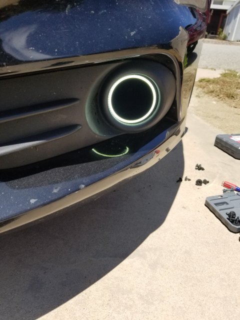

I was interested in @GrayFiST's intake hose solution since I saw his thread introducing them. When I got my ST200 inbox I PM'ed him regarding them as I hadn't seen any updates but luckily he was able to whip up a pair in a couple of weeks. Overall I am loving the product in both function and looks so far.
Install is pretty easy, probably a 2/5 as you do have to remove the bumper to make it easy enough to access the bolts and move the location of your washer fluid reservoir. The fit is a bit tight for the 3d printed bracket but nothing a little bit of drilling wouldn't be able to solve according to @TyphoonFiST who also has this set installed(i was able to brute force mine on. It's definitely a tight fit as the creator was telling me when he sent them. 20190720_130902.jpg

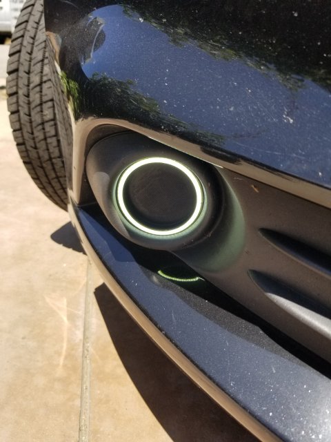

Once you get the lights in position the Led rings are plug n play into the original harness and they are pretty bright. Bright enough to be seen in broad daylight as in my picture can't imagine the output at night. 20190720_130851.jpg 20190720_130846.jpg
Induction noise seems to be a bit improved due to the added ramair effect, as was expected. Overall everything fits pretty well and I'm definitely impressed with the finish and quality of the parts
Only recommendation I would make is to crimp the wires before installation in the new light harness as mine fell apart while installing, and it was a pain to crimp them back while the lights were in. Better to do it before starting and not have to worry down the line.
Definitely hope Grayfist makes more than a few sets for the community as there is also utility as brake duct vents instead of just an ST200 hose solution, which seemed to be a popular suggestion in the original thread.
Overall very pleased with the product and would definitely recommend as a solution for the ST200 hose, definitely a better position for airflow as opposed to under the headlight.
