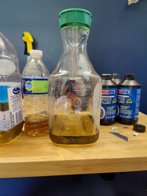

Finished up a planned brake fluid flush yesterday and I'm VERY please to report my brake noises are gone. It looks like the calipers were indeed dragging. For the record, I did not bleed the ABS or clutch (never, ever do)
This is the Amsoil brake fluid that was in there since 7/21/19 for 20k miles. The fluid is in bad condition and definitely needed to be flushed. I'm not surprised my calipers were dragging. OP, how does the fluid in ur reservoir look compared to this urine?
