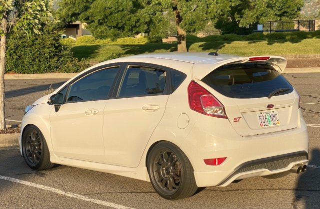

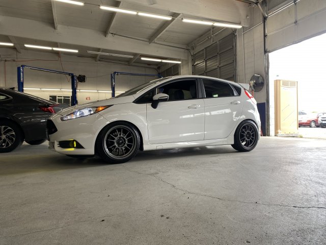

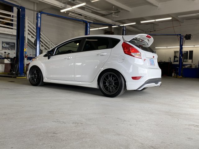

Just installed my H&R Sports on my car and it looks amazing. One issue I’m running into is I’m rubbing on the driver front fender liner(not the fender itself) but not the passenger. I’m running Hypergrams 17x8’s with 205/45/17 tires(should fit fine from my research) but I rub at almost full lock and on some bumps. Tried adjusting the liner and it’s all fine. Thinking of just clearancing the liner since I’m not really sure what to do at this point.

Tire is too tall*
6,370
6,005
They aren’t much different than running 215/40/17’s, and people don’t have issues with those. I’m just lost why only the drivers side does it.
It may not seem like to much difference but it is just a bit taller. FWIW H&R springs drop the car a significant amount you might want to get some camber bolts and add some negative camber in for outer clearance which is most likely where you are rubbing . Also you might want to flatten the inside fender lip as it literally sticks out horizontally and is a known spot for rubbing as it will literally cut into your sidewall.
Oh and ya that can happen if your low 215/40 as well but general rule of thumb for 17’s on cars is 215/40 not 205/45

Thought I’d update this
I got new 205/40 tires and no longer rub, however the ride is very harsh for my area and I’m not a fan of the entire suspension and wheel/tire setup. I’ll be selling these wheels/tires and springs and going with KE Motorsports PRO 15x8’s on a 205/50 and Swift springs or coilovers of some sort.
