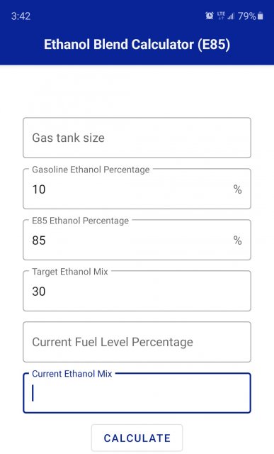

Is current ethanol mix if I'm filling up on top of an E30 fill? Also if doing E30 on top of 93, does this box get the 10% or 0? As there is already a box for gas ethanol. Sometimes simple concepts are lost on me.
A Simple way to fill up.... 8 gallons of 93 oct....then 3 gallons of e85. This includes the 1/2 to 1 gallon of current gas in the tank for our 12ish gallon system.
I assume if sticking to this method I dont have to compensate for whats left in the tank preloading the mix? Alleviating the need to clear with 91/93 after a set number of tanks? If so I like it! Apologies I am going cross eyed tonight trying to tackle all the things I struggle to comprehend fuel and accessport wise.
Current Ethanol mix is the ethanol content of what's currently in the tank.
If I'm running 93 this stays at 10%. If I'm on E30 it goes to 30%
You're making it complicated.
I've added up to an extra gallon of E85 (for 4 gallons) on my E30 tune and the only thing I could measure is that torque dropped a tad, and my HP went up a tad. The thresholds of error for what is safe is pretty broad. Just keep an eye on your OAR gauge and if it's still -1.00 you should be fine.
^^^ This.
I see you are running Dizzy Tune @akiraproject24 . I used to run those tunes when I had OEM turbo. He even mentions in your tunes e-mail that for E30, just drive to about 1/8 a tank, add 3 gallon E85, top off with 93. I did that for a year and never had an issue. Easy Peasy. That tune from Dizzy has variance built in to accommodate a range of ethanol content.
If you're still worried just monitor OAR + IGN CORR on your AP

^^^ This.
I'm gonna do like this. Ive seen vids with spread sheets and what not. Seeing that I didnt even bother trying my E30 tune last year. Car garaged for winter but....will run as suggested here. I guess I can then use the calculator if for some reason I choose to fill up with more in the tank. Appreciate the advice here.
Just divide the ratio. So if you're at half a tank it should be about 1.5 gallons of e85 and the rest high octane. I tend to err on more e85 than less when in doubt. I'll make a point to run the tank close to empty every now and then to reset the ratio to avoid ethanol concentrations from creeping too high.
