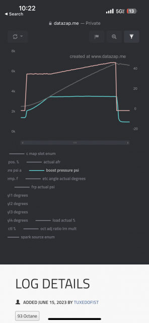

so I’ve got my s280 installed and I’ve gotten my 1st revision from Adam. Now on this map I’m not getting passed 14lbs of boost my wgdc is hitting 40% but the boost target is between 21 and 23lbs.. I’ve triple checked the solinoid and everything is routed correctly and I’m not loosing boost up top at all… I’m at a loss IMG_0337.png

How much boost did you hit on the base map?
If you hit nearly the same on base map, I’d venture a guess that it’s a boost leak based on the behavior. Something can’t hold more than 14 PSI.

Its almost exactly the same as my base map I would actually peak a little higher on the base map.. Adam said he thinks my solinoid is routed incorrectly but I’ve triple checked it and nothing else is loose at all intercooler, charge pipes crossover everything is sealed

I agree with the above post, in that you're not going to get much help once he has decided what the problem is . . . . unless you just like being talked down to.
So, the way I understand it . . . the base tune at 14 lbs is allowing the WG to open based solely on its own spring pressure. In subsequent tunes, the WG solenoid is used to hold the WG shut to allow for high boost levels. So, in theory, if you are still seeing the same 14 lbs, the problem is in the WG or solenoid, which is why he immediately assumed its plumbed wrong. Unless a boost leak is magically keeping the exact same boost levels (unlikely).
If you're sure it's plumbed correctly, double check that you have the solenoid wired correctly and that the connections are sound. At some point, you might have to switch out the solenoid to troubleshoot.

Good point on a leak likely not being so consistent. I didn’t even look at the graph. Damn newborn life got me delirious lol. Agree it could be a faulty solenoid if it’s all wired and plumbed properly

Thanks y’all I have an extra solinoid to swap out with.. so I will start with wiring and swap it out soon I have a gender reveal today … so it’s gonna be a couple days…. Also thanks for the other insight as well I just switched from dizzy for my BT tune.
