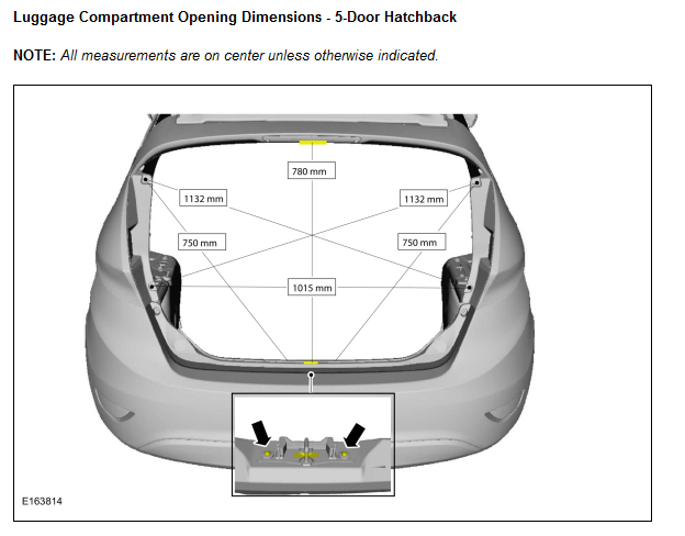

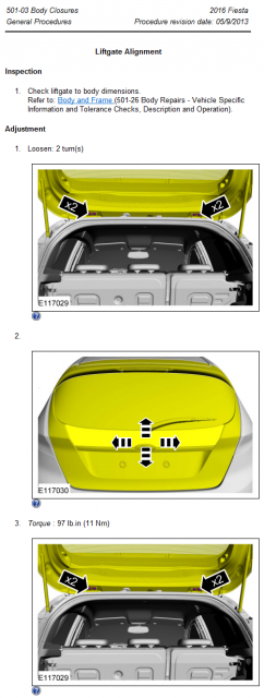

Anyone have any ideas? I'm sure it has to be due to the rear end accident and the "repair" that was done. A short or bad grounding, crossed wires, etc. The place I bought the car from couldn't figure out anything for me. I thought maybe it was the hatch latch assembly and they replaced with a new one, no charge but that isn't it.
