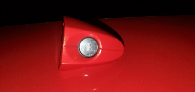

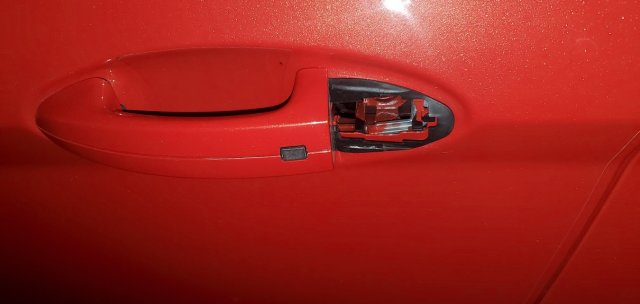

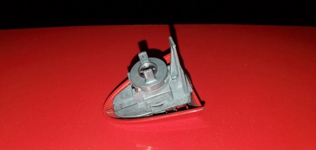

I went in for the door latch recall about....dunno....two months ago...ish. They had to have the car for 3 days as they also did the center dash actuator for the second time in the life of the car's 37k miles (only). regardless of that, when they had the doors apart, they found that the cables going to the latches were shot to hell. They went ahead and replaced those cables for free. I was very pleased as I was already dropping over $800 on the actuator replacement. So here it is, two months later. The day after I get back from Vegas, the door lock (back half of the driver side door handle) just falls off to the ground as I closed my car door.
I have a service appointment on Monday morning. I'll update after I get the car back. I am very curious as to what they have to say.
So, they have to order the part. When it come in, it has to go to paint as they get in shipped in a matte black finish. Then they will call me to come in for fitting. They didn't say anything about how much it will cost, they just gave me the car back and said they'd let me know when it was ready for install. I am assuming since there was no price/cost or paper work filled out, that it is covered under the recall.

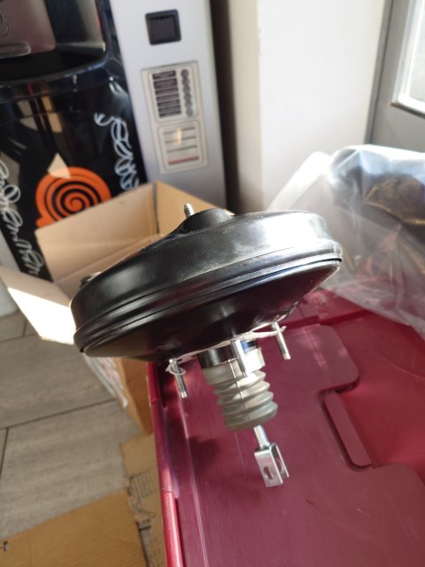

Ok i guees since im new here ill post something. So i bought my new used fiesta st last month. And the break pedal made an audiable pop when you pressed it all the way in and then released it. My friend assured me it was just neediing some lube. Well a week later i went for a ride and the poping stoped but now there was a hiss coming from the break pedal inside the cabin. Took it to a ford dealer and it was the break booster. It was puncured since they didnt turn on the car when bleeding the breaks last time they were changed. So i decided to do a full inspection and changed brake booster, break fluid, transmission oil, did a full service and also checked if i had a model with the oil belt(i dont luckily) and they also changed the front engine mount all for 1200eur. Then they f something up and the day i picked it up the hill assist wasnt working so i took it back and the break switch was busted. Ok now they replaced that also and gave me a discount. But the dealer said that there are some weird codes on the engine from before i got the car and he couldnt fuigure out why would they be there. And they told me that i should bring it back in a month for a free code inspection. Any thoughts? It is an imported car from germany to slovenia so maybe that had to do with something. Honestly thought that a newer car would have less problems than my previous 2010ish cars but nope its almost worse xD. Love the forum tho theres so much usefull stuff here.
Edit: 118000 km
Edit: 118000 km
Sounds like all the problems you have had to fix were the result of bad repairs/mechanical work. The weird codes may be the result of someone having tuned the car in the past.
