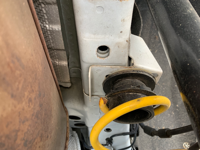

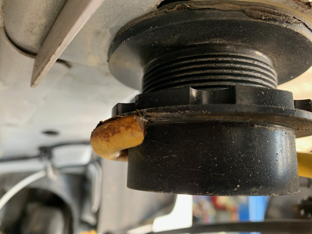

Attached are photographs of the right rear of my FiST with ST Suspension's XTA coilover kit. The springs have 7500 miles on them, rarely see wet weather and never see salt. That spring is rusted through at the other springs are all corroded. ST's response? Our warranty doesn't cover corrosion (not stated in the warranty found on ST's web site), you've dared to use your street-driven car on a track day and *any* track use invalidates the warranty (not stated on the warranty found on ST's web site), and our springs are only covered by a two year warranty (the springs are part of a coil over kit which is covered by a 5 year warranty). John Carnell, ST's Sales and Technical Support Rep. has spoken and there is no recourse.
This isn't just a bummer that I bought $1200 of coilovers, thinking that I was buying better components by going with ST, this is a safey issue. That spring is close to pushing itself off the pad.

non issue to me, looks like surface corrosion. if it rusted through and deteriorate the metals, that's an issue but I don't see that here. muffler looks worse.

Take another look - there's 1/2 a coil gone.

I'll take your word for it, I don't see it. If that's the case, too bad they won't back up their product. Shame on them.

Oh wow. Yeah thats a busted spring for sure. Id pull that garbage off. Or maybe order some swift coilover springs front and rear. That will for sure fix the problem.

For what it's worth - this is not corrosion (what you called "rust through"), but cracking. It's a high strengh material, and is susceptible to cracking. Cracking could be purely mechanical in nature, or may have been initiated by corrosion. I'm thinking it's the latter - and, for that, having a defect in the coating may have been the precipitating event.
Either way, this means that the coil is defective, and should be replaced under warranty.

Man, keep up the material science! You're absolutely right, the spring did not "rust through" but broke. The other springs have troubling signs of corrosion, leading me to believe that they may experience a similar failure.
