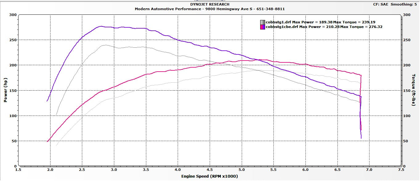

Pretty sure I'm right-
21.05hp/37.13tq, easily the largest claimed increase in performance that you can add with a single bolt-on without a tune and without a bigger turbo.
http://www.fiestastforum.com/forum/threads/5574-MAPerformance-2015-Fiesta-ST-R-amp-D-Project-(Tuning-Intake-Downpipe-Exhaust-Turbo-Kit)?p=105199&viewfull=1#post105199

Except that you need to be on a stage 1 tune... Good thing MAP discloses that when mentioning that gain on their product page. /sarcasm.
Yeah, it's crazy how many vendors' products gain power when they are using a stage 1 tune and are compared to a completely stock platform...
