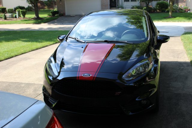

Looking at the Ford catalog, it lists 2 different light assy. for each side. one With complex reflex design. 2014-19, with reflect design. one with out, how do yo know which is which. The pic. is my car IMG_0021.JPG

Ask your dealer's parts department they will check the VIN of your car and give you the correct part number.
You can then buy from where you want.

I'm going through this on my car right now. Just received two new lights from Ford and they have chrome trim around the lights. My 2016 has black trim around the lights (inside the lenses). I will get part numbers in the morning. I do remember being the most expensive model lights.
I looked at a regular base model type Fiesta at the grocery store tonight and it didn't have the chrome lights either, black just like my current lights.

Figured out my car has the Spyder Black head lights, previous owner replaced them, add to the list of mods done before I bought the car. I will be buying the Spyder lights, I like them.
