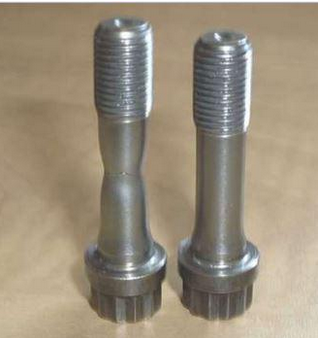

BTW: TTY bolts will stretch only above the part threaded into the nut.
This of course changes the thread pitch and making it seem that it will not thread in all the way.
I know this obviously the issue are having.
The only way to fix this is to replace the bolt.
Again obvious.
If you can't find a match at a hardware store that is not TTY then your stuck with OEM.

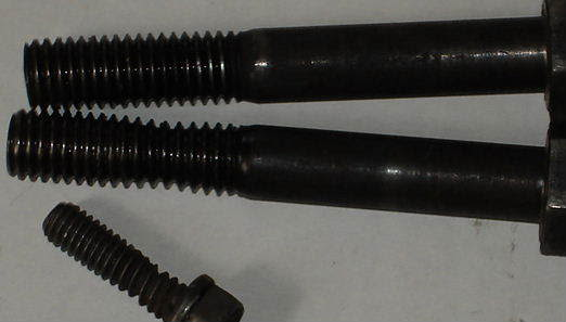

Although your photo is a very good example it does not explain why the bolt will not thread further and resulting in snapping of the bolt in that area.
As for the actual bolts in question that I have removed and replaced many times when helping to design the front bracing, these bolts don't bottom out and therefore should continue to thread in.
Depending on the manufacturer, some bots also stretch in the thread area (sorry I don't have a photo example) as I tried to describe above.
By stretching in the thread area, the pitch changes, preventing the bolt to be threaded in further as if it were cross-threading and therefore not tightening all the way as the OP describes.
I would think it is better in this case that the bolt that cannot be tightened, rather than having to remove a broken off one.

.... some bolts also stretch in the thread area (sorry I don't have a photo example) ......
I have actually seen smaller bolts like the one near the bottom that were like that.
Thanks for the info.
