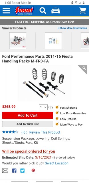

hello all, ive been searching the web for so long and i cant find if Handling Packs M-FR3-FA is just the factory suspension for the Fiesta ST? Its cheap only about $280 for the entire suspension set up. I already have white line lowering springs and i just want to swap them over. My problem is, are the M-FR3-FA shock going to make me lose performance or are they they exact same shock as the factory FiST shocks?

That is for the NON-ST fiesta to lower it from the asinine height it is at.

It's one of the two items in the massive Ford Performance catalog they gave us at Octane Academy made for the Fiesta, and it's not for the ST. It says it improves the handling of the Fiesta S and SE without degrading ride. It lowers the car a half inch. It would not be the same parts that go on the ST, but a definite step backwards.

Everyone above covered it. Those are for non ST fiestas. If you want shocks to put your springs on, I would go for some Koni yellows. They've got nothing but amazing reviews from everyone I've ever spoken to.

Thanks all very much i appreciate it.
