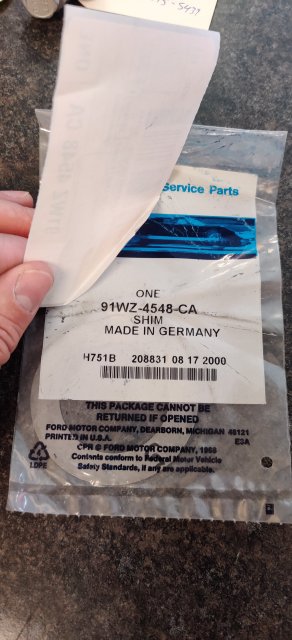

Got the shim in last night. Just drops in and is held in place by the bearing race. Here's the $90 shim. Whilst the other shim prices were only $1.50 explain that's shit Ford 😂. You'll notice the packing date on the package. It's 20 years old

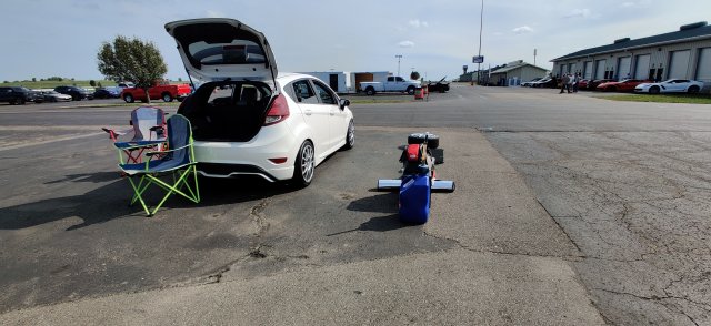

Not trying to sound like a broken record with the LSD deal but holy shit does it change the car. 11/10 would recommend for first mod. The car was amazing on track. Just need to dial in the suspension IMG_20200915_153836.jpg
14,942
7,380
If it wouldn't take almost $3K I don't have, out of my budget for brakes and suspension, this would have been done already. [wink]
My biggest gripe with Ford about this car is NOT all of the little shit that everyone else is bothered by, nor even the major shit of their crap paint/paint prep work, but it is that they did not even offer us an even extra-cost OPTION to have a limited slip installed, right from the factory. [:(]

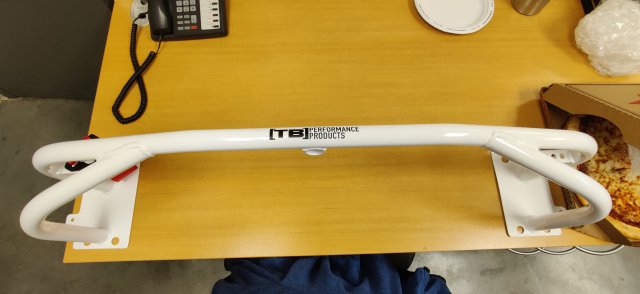

Haven't spoiled my car in awhile and just got a promotion at work so I figure I'd get myself a late christmas present. Ordered my TB Performance Crash bar in white powdercoat with the tow hook option. I will soon order the BA intercooler to go with it.
Erick_V
788
925
Texas
I’d love to know the difference in weight between OEM and the TB unit. It’s very fairly priced all things considered
I found online somewhere it said 17lbs lighter

Crash bar shipped Friday. Ordered it Tuesday. Pretty quick considering its made to order and I chose to have it powdercoated
