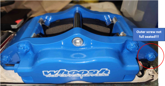

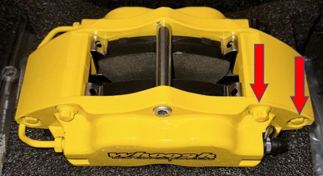

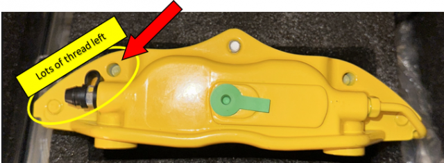

Here's some photos. Lets just say I'm not happy. The finish is a light blue. Doesn't match pictures on site for finish. Obviously different brake retention design. One of hte pads friction material was damaged, and the screw doesn't sit flush. Hopefully I can just get my money back for the brakes and spacers and be done with this adventure. This is all pictures from the one caliper I unwrapped from the shrinkwrap.
Out of the box paint was already chipped on the end of the big bolt on top of the caliper. You can see it in the pictures. I wasn’t too concerned as you can’t really tell when it’s on the car. Also when I opened the box it smelled like paint. I wonder if the paint wasn’t cured and when I took the shrink wrap off it stuck to the paint and chipped it
This is exactly why ISO certs matter. If the quality of the paint is this inconsistent, ya gotta ask where else did they fuck up? Let's focus on the very scary quality issue pointed out by @thecman02 .
Notice the screws on both the calipers. Let's start with the two center-most screws. On neither caliper are those screws fully seated. I thought, maybe that's by design. But then looking at the backside of the yellow caliper you can see that those center-most screws still have a ways to go! Again, maybe by design but then look at the outermost screws on the same yellow caliper - fully seated. Now the scary part - the outer screws on the blue caliper are NOT fully seated as they are on the yellow one.....yea, they didn't fully assemble the blue caliper. Furthermore, I respectfully submit that the center screws also prove that neither caliper is fully assembled. I mean, why wouldn't you fully seat screws holding a goddam caliper together?.....because they are rushing them out with little to no quality control.
If only there was some governing body that could encourage proper quality control? :cautious: Send those calipers back fellas!
@Ludeem1 Wilwood is a great choice. Also ISO certified, go figure. Let us know if you find the street seals for the pistons! lol
I just emailed Ron. I told him about the different pad retention and paint chip. I told him I want to return the kit. Hoping he lets me return it. I also have to return the EBC brakes that didn’t fit. If he tries to send me the kit the others have gotten I will decline. I decided I will go with Wilwood
You all know I'm not Whoosh's BIGGEST fan but I respect what he's done for our platform. I spend lots of time daydreaming on his website! :). I also have no doubt he WILL absolutely do right by you guys. He may eventually ban my IP from his website, but you guys will be good lol
Ya I am not going to yell at you in the other thread:LOL: Maybe Hank sent some of the wrong Calipers to Ron and Ron sent them out to Ludeem without opening because pallet of Caliper boxes all look the same outside says 330mm Big Brake.
It happens in shipping.
Rebranding is nothing new and lots of people do it. I also cannot blame anyone for not wanting to tell people who their source is. Common business rebrand practice . Car guys just tend to get nosy about this stuff:LOL:.
Anyways interesting convo and back to your end goal.
I won't argue rebranding. My Cobb sways are clearly Eibach. But are you starting to see why I was so concerned about the source of this life saving part? My life would be in the hands of this caliper & it obviously has some issues. From QC to just sending customers the entirely wrong part.
Run for your lives people. And make sure your shoes are ISO certified so can stop yourself :p
Interesting process. Painting after being fully assembled...
I thought the same thing when i first saw them on Ron's site. I can only assume they throw the caliper together, spray the WHOLE thing down - even the pistons by the pics we have in this thread - and then bake and ship. Those small chips of paint on the pistons can potentially get into the hydraulics!!!! They obviously don't check the bolts to preserve their paint job...:eek:

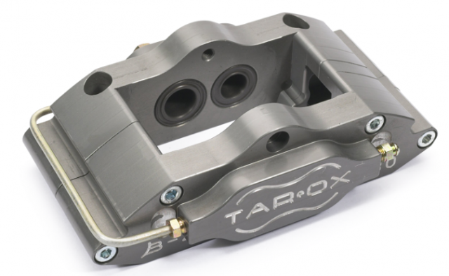

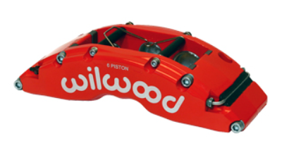

Notice Tarox and Wilwood ISO certified calipers below. Neither bolts or the hydraulic line are painted & the pistons are CLEAN. They were assembled with care...
