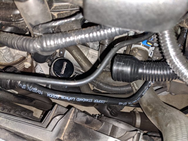

Also ordered a symposer delete kit, as I’m getting out of sync stereo sound from the front and back of the car now. It’s a bit distracting and annoying, so that’s getting fixed as soon as the kit comes in.

Ripped the symposer off this afternoon, and spiked it on the ground when I was done. Just as annoying as I remember it being on my '15.
Good riddance.
