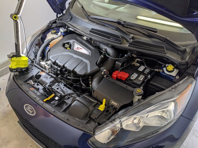

Pulled the trigger on the Mishimoto intake. The pros and cons of this intake are known to me, and I do think I had finally sorted the fitment on my '15, so that's knowledge I can apply to get the same quality of aural experience that I had before. This I will be installing myself.

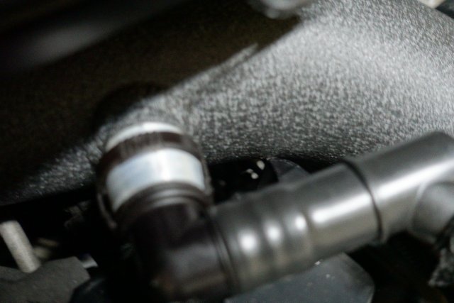

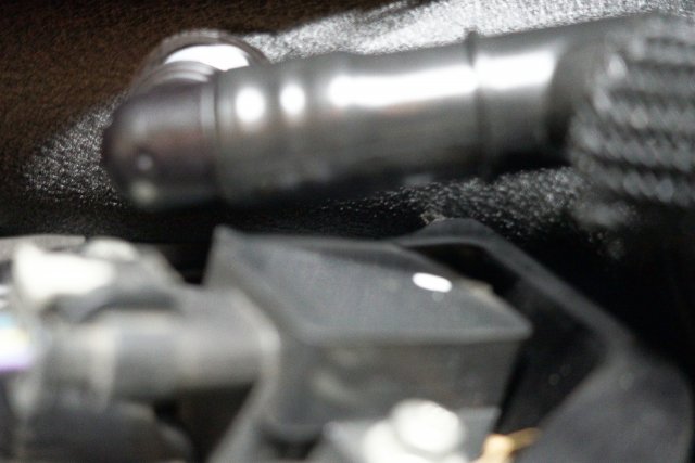

Intake's on, and no great surprise, it rubs on the plastic valve cover at the inside corner of the hard pipe. I had this exact same issue with my '15 when I first put it on, and I have no idea what the trick is to getting it right the first time. There may not be one; I finally think I got the fit right about three months later on my '15 after tweaking it at least once a month.
But that's irrelevant right now, because the noises are glorious.

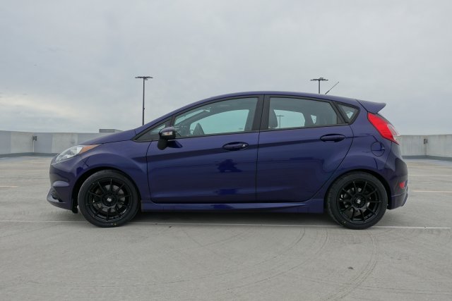

Pulled the trigger on an Accessport, as well as a set of Sparco Asetto Gara's in 16x7, with Indy 500's in 205/45. Ran this same set on my '15, and they were near perfect for a daily Summer tire. There's definitely nothing better for the money.

ALL of the Sparco wheels look great on our rides, and the only reason I don't own a set is because of their cost (vs. Dekagrams, which I actually bought for far less $$$ than TR gets for these 'exclusives') and their WEIGHT (ditto for vs. the Dekagrams). [:(]
I thought about Dekagrams, but given the lack of tire options in that size and that I wasn't really looking to run a 200 treadwear Falken, I went for the Sparcos. They are still significantly lighter than the OEM wheels (17 lbs. vs 22), and the price seems justified. This is the second set of Sparcos I've bought, and like the first set they came perfectly balanced with very few wheel weights. I had a set of Motegi wheels on another car that each had probably a dozen weights on them, and they still weren't entirely balanced (and I had tried twice).
