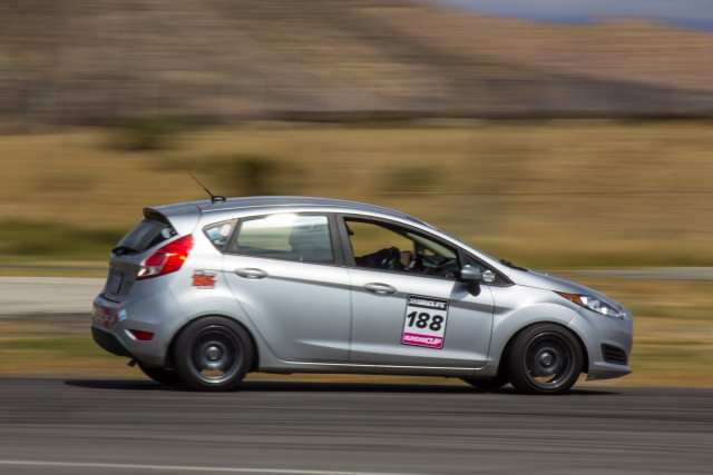

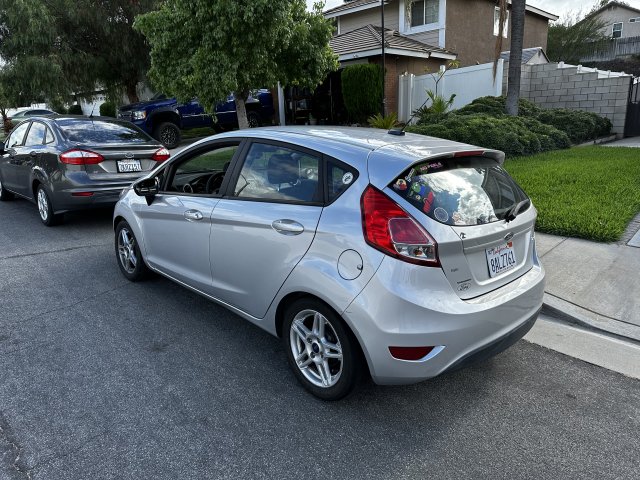

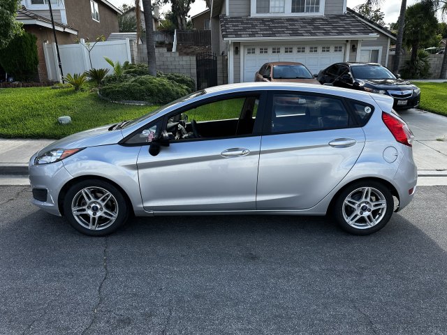

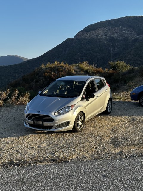

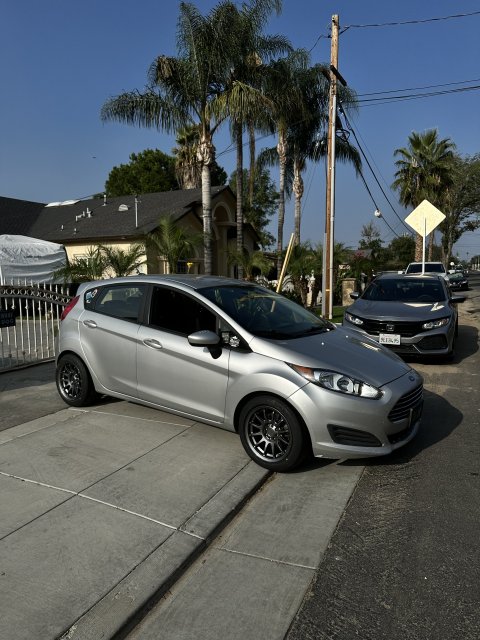

The egg got some love over the long weekend. I finally installed my swift spec r springs, oil change, camber bolts, fresh rotors, hawk hp+ pads and fresh castrol srf brake fluid.
got an alignment and the car sits at -2 camber up front with 0 toe. -1.7 camber in the rear with 0.4 toe in. I unfortunately couldn’t find my measuring tape to measure the exact drop for the springs. But it looks to be around 1.5” drop.
this new setup lets me throttle out of a corner much sooner with all the new front end grip and better rotation. Still on stock wheels with 195/50/15 federal rs pros. See pics below for height reference. IMG_8707.jpeg IMG_8708.jpeg IMG_8710.jpeg IMG_8616.jpeg IMG_8617.jpeg IMG_8614.jpeg

The pictures in the street were right after I installed them so I don't think they had settled just yet. The pictures in the mountain were after driving for 3 hours so I think they are plenty settled by then.
I'm taking this car to grid life for sundae cup. This car isn't any where near the max of the rule set so I'm just going for fun vibes. A podium would be cool tho lol

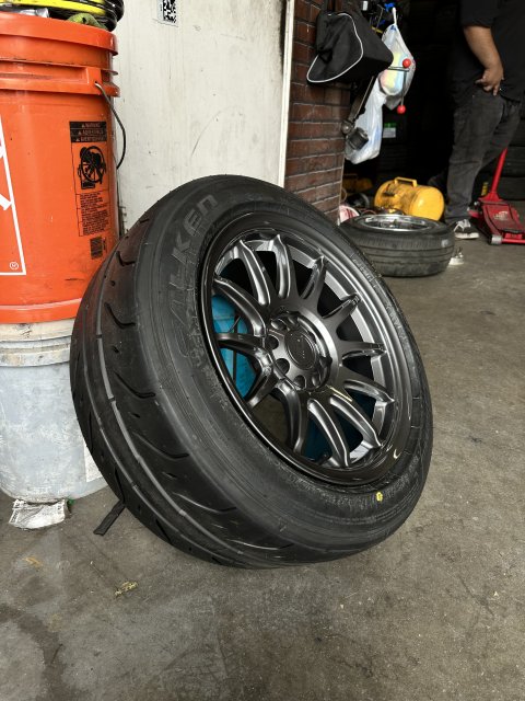

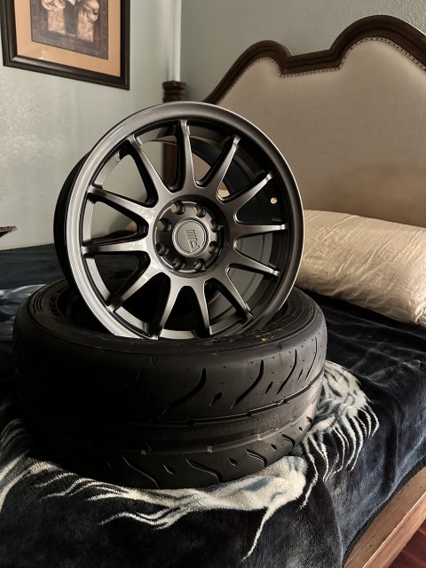

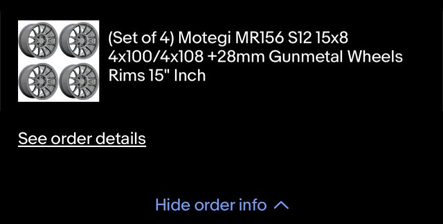

With sundae cup at willow springs being at the end of the month and my new alignment and suspension feeling better than the previous stock setup. I decided to splurge and get some new wheels and RT660 ( I needed the rt660s anyways since it’s the spec tire for the class). I’m hoping this gives me a good shot at going for the podium now. I picked these wheels because they’re both 4x100 and 4x108 since I want to go get back into an integra eventually these wheels will be perfect. IMG_8808.jpeg IMG_8809.jpeg
side note: tire rack has a $100 instant rebate on RT660 so you basically get $100 off right away :)

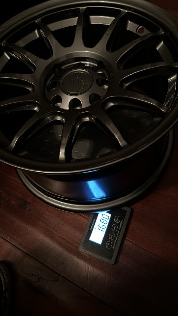

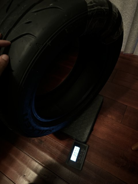

The sundae cup spec setup just showed up last night.
205/50/15 RT660 (20lbs)
15x8 +28 motegis (16lbs)
I was hoping this setup would be lighter. It looks like it’s going to weigh 36 pounds total. I’ll be weighing stock vs this setup once I’m swapping. Then I’ll be going to my local canyon to test for rubbing. IMG_9030.jpeg 36868387-D3C9-4E4F-A738-2209B5FB4B81.jpeg IMG_9034.jpeg

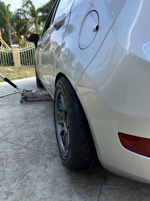

Thread Starter #33

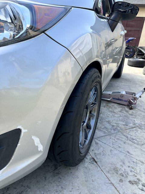

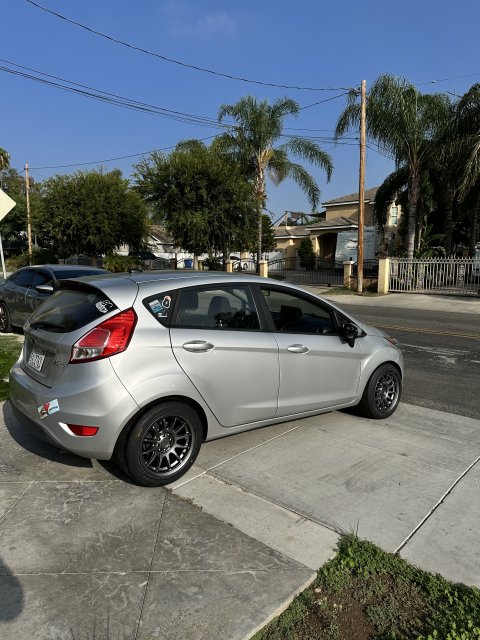

Looks good! Any rubbing at full compression?
There is some tuck as the suspension compresses, but with that amount of poke, I'd be little surprised if there wasn't some fender contact there. 🤔 Hope it works out! That'll be another PIA if it doesn't.
No rubbing at full lock or at full compression. I went to two mountains this weekend. One was a high speed mountain with lots of long sweepers, and another with very tight corners, hair pins and such. I didn't experience any contact. Even hitting my favorite jump on one of the roads didn't lead to any contact. So I think I should be good :) The car could still use more camber to even out the tire wear.

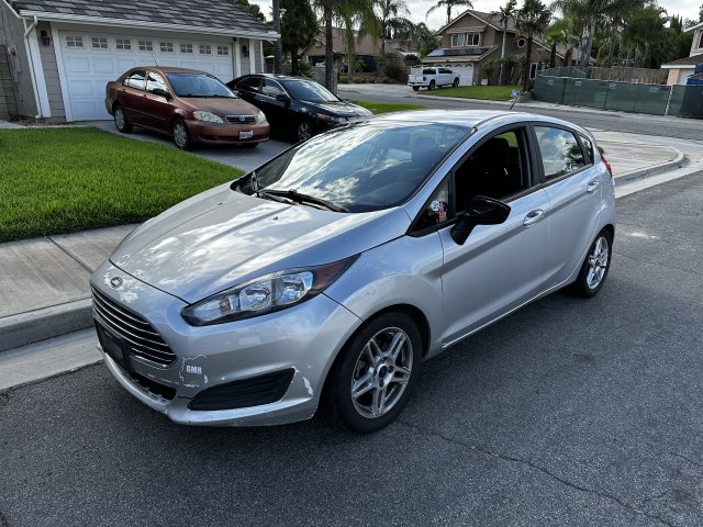

Nice to see another rare silver one out there. Have only seen one other in person since 2014. Nice thing is that they don't show scratches!
This car has gotten pretty banged up since I acquired it. Lots of rock chips, cracked bumper, and more. but you're right, after a wash the good paint hides most of it. Some people don't notice until I point it out to them
