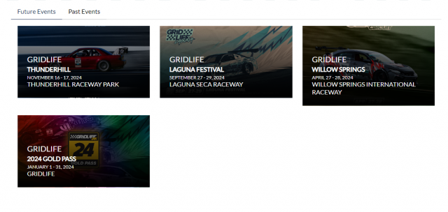

I signed up for the full west coast series for Gridlife.
Time to see where I land in Sundae cup.
Is anyone else going to be at any of these events?

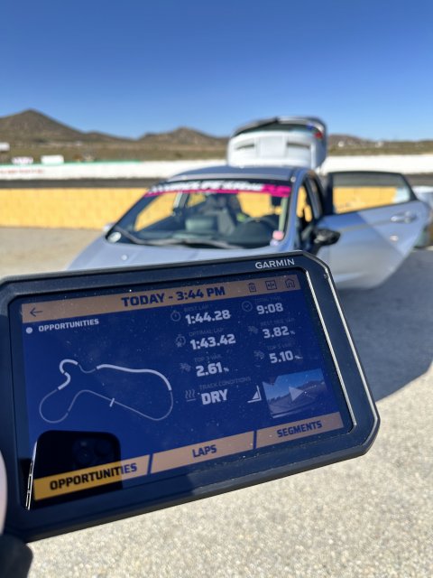

I just realized I haven't updated my page in quite a few months now. Nothing has really changed on the car since my last update, besides adding the ST wing on to the car from a fellow member. But I have done 3 track days now. I went to horse thief mile, streets of willow and big willow. Horse thief mile and streets of willow were both days in pouring rain. so no PB but lots of sliding and instructing all day long. Big willow was very good seat time. The current sundae cup record at big willow is 1.49. I was able to do multiple 1.44 laps on RT660 that were showing cords. I had a couple laps that were on track for a 1.43 but I would always get traffic. I just ordered fresh RT660 for the event coming up in just under 2 weeks. My goal is to get in to the 1.41-1.42 range on some fresh rubber. This sundae I will also be looking at taking out some weight from the car to hopefully gain an extra tenth. The past sundae cup saw 12 drivers and the podium was separated by one second. So I'm going to be looking all over the car for things I can yank out within the rules

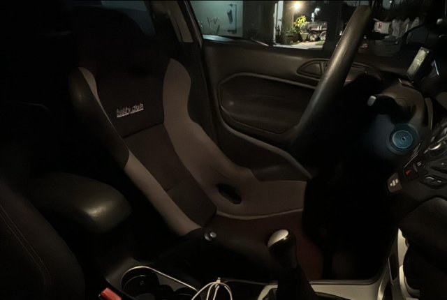

Apologies for the dark picture. I finished this job up last night in the driveway. I finally got a bucket seat in the car. Should help keep me in place a lot better. I sit about 2” lower than the stock seat which should help with the COG since I am a chunky 230 pounds of fluff lol.
the OEM base seat weighed in at 41 pounds with rails and hardware and everything. This seat is a 14 pound weight savings, the seat with hardware and rails and everything is 27 pounds. I could definitely find some lighter options. But this was cheap from a friend and the seat brackets were on sale. This whole setup was just $250. This may be the only Fiesta SE with a buddy club in existence lol
Do you use/route the factory belt right across the top of the side bolster?

I ran out of sunlight so I stopped the install there. One of these days during the week, I will be routing the factory belt through the side bolster to make it safer.
And before anyone asks, no I am not currently driving the car like that. I am currently commuting on my motorcycle since the weather is perfect for it.

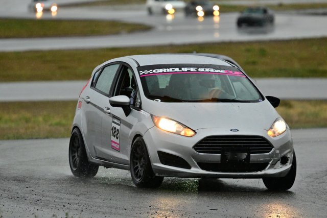

How were the 660s in the rain/on the wet track?
They were better than I expected. In the rain with lots of puddles I was around 10-13 seconds slower than my PB, which from what I gathered online is about as good as it gets for rain vs dry lap times on the same setup. I running my pressures pretty low. I was at 24 psi up front and 26 psi rear.
I've driven in the rain a lot with the RT660 and I do not have TC or ABS on my car anymore. If the tire ever hydroplanes it would re gain grip pretty much the second it got out of the puddle. Even when they were past the wear bars they acted this way.

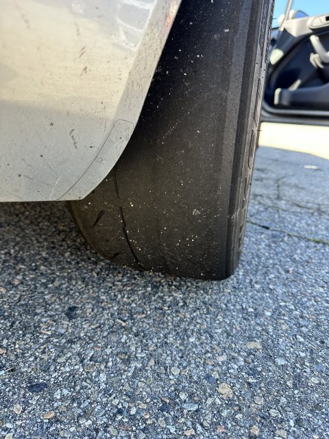

I got a lot of replies on my instagram about my tire life and wear. I don’t have any special tricks or anything. Going to share my setup and tips and hopefully this helps someone on here as well. On the left is my RT660 after 6 track days. All 4 looked roughly the same. The right is of course a brand new RT660.
the used set survived 4 track days at streets of willow, one at big willow and one at Buttonwillow.
My alignment specs are
-2 camber up front
-1.7 camber rear
0 toe up front
0.4 toe in rear
Rear has no work done to it. It’s just what I got on the twist beam roulette.
I like zero toe up front for the better wear.
a little more negative camber would probably be beneficial but not much. I suspect -2.5 would be on the money.
I’m really careful about adjusting my tire pressures to different scenarios.
I run 28-32 psi hot on track depending on temps/ condition.
commuting is 40 psi
Rain is 24-26 psi
Canyon driving is 32-35 psi.
I always air up my tires before driving home from the track, or after rain etc.
after every track day I rotate my tires from front to rear.
track day #1-2 on these tires is the best grip you’ll get
Track day #3 falls off a little but not too bad. This will probably vary depending on how aggressive the first 2 track days were.
