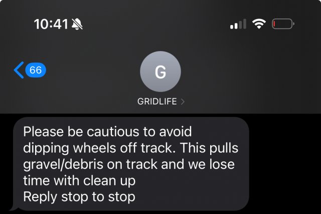

I was dipping tires a lot on one of my sessions and got this wonderful text 5 minutes after my session ended lol.

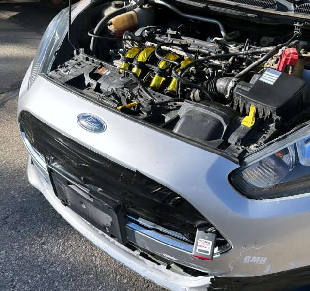

In an effort to go faster on day 2. A friend gave me some duct tape and I sealed off the whole upper grill of the fiesta and also gave me a little bit of gold heat tape which I put on the intake manifold.
the intake temps went up another 15-20 degrees with this combination. Making my intake temps 40+ over ambient. Not good since we were in the high 70s!
the coolant temps run at around 205-210 with this setup, normally they’re closer to 180-190.
despite the higher intake temps. I saw immediate time drop on the straights and corner exit with all the tape.
HA! In WRC tarmac rallying, this is fully expected and considered merely 'force majeure' or par for the course for the crews further down the start list for the stages.
They might even make some suspension adjustment, or tire compound choice changes/decisions because of it! [thumb]

Yea, some of my friends that were spectating were telling me about how the flaggers would grab the black flag as if they were going to point it at me, we all thought it was pretty extra because the amount I was throwing on track was minimal and it was off of most peoples race line, mine was a more narrow race line due to the elevation and needing to keep my momentum up. As someone who hosts 1-2 events a year and helps out with another organization I can understand the annoyance. Because as a host you will get drivers complaining about debris and in a competition format drivers aren't the biggest fans of it.
