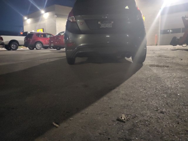

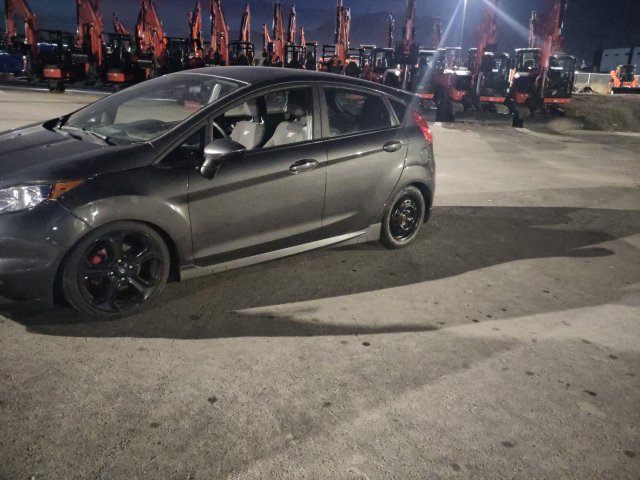

Was driving, felt like I had a blowout, but when I got out and looked everything looked fine, must have been parked on the missing tread lol
At work the next day lifted it up because I was thinking wheel bearing or something on the suspension, as I'm doing that on the passenger side coworker walks up and points out my driver tire, didn't feel too smart today haha
Anyways anyone ever have this happen? It's a Falken 205/40R17 "ZE960A/S" also new tire recommendations would be great, in the market now

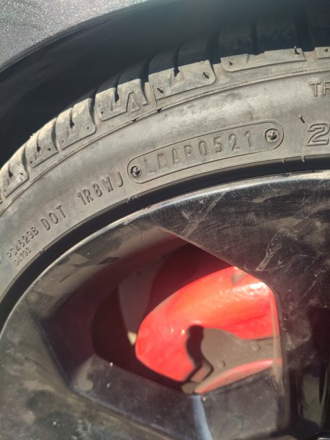

What's the production year on these tires? I run a lot of take off race tires to save on cost and I've usually only had this problem with rubber that is very old. I'm guessing these tires have been on there for a while? Just because I tire has tread don't mean it isn't dry rotted out.
I think 2021 if I'm reading this right
