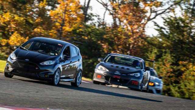

Recently bought a 16 ST building it into a fun street/track car. Full interior street class. Ive raced a fully built Coyote swapped foxbody for years. Parted and sold that last year, I wanted something fun, light, cheap that I can drive to the track.
