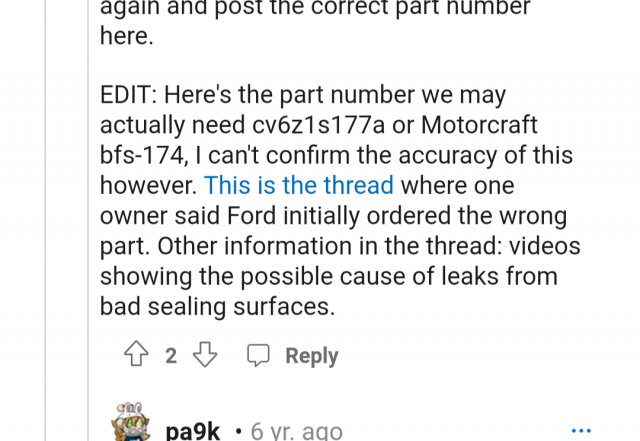

@FiestaSTdude Would you be able to give me a part number for that seal you were mentioning? I can't seem to find anything for it on RockAuto.
I've only done a cv axle on my focus not the Fiesta so I've never actually had to buy the seal. I'll see if I can find anything tomorrow though
