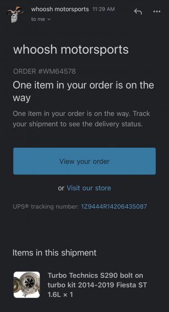

(2) S290 kits will be available for purchase later today on the whoosh site
these 2 are the only kits available anywhere - could be 2-4 months before parts and product resume for the S290
I think you should make it legally required for anyone that buys a kit to post results.
