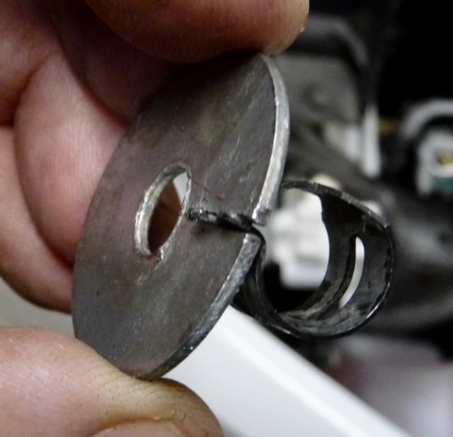

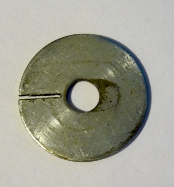

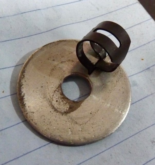

I was able to drop the turbo in from the top mounted to the exhaust manifold with the boost piping and the GFB DV+ attached. I forgot to install the one pressure line that goes from the barb on the compressor housing to the waste gate control solenoid. I did not want to remove everything to install this one tiny hose. I could get the hose onto the hose barb from the turbo, but there was no way to get the spring loaded clamp open enough to get it in place. I couldn’t get any kind of pliers into the space to hold the clamp open.
So I made this high tech tool out of a fender washer. I forced opened the clamp by working it onto a drill bit until the 3 tabs on the clamp lined up. Then I slipped the tabs into the groove that I cut with a narrow kerf hacksaw blade. I slipped the clamp onto the hose (being held open by my high tech tool), put the hose onto the barb, slid the clamp and washer down the hose until I was positioned properly over the barb then popped off the washer and allowed the spring clamp to close….easy peasy!
