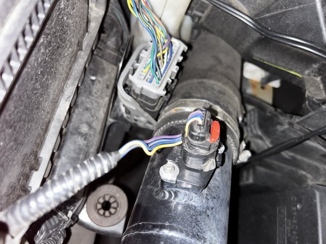

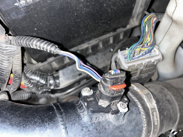

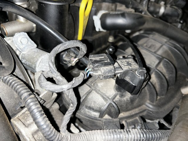

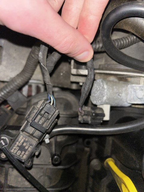

Here’s the pics I managed to get of everything under the hood.

It’s kinda a mess in there and idk what any of it does tbh 💀
not sure if anyone can spot what could be causing the issue.

jPEG840* That connector is taped this concerns me and i see it tapped further back into the harness. Also the MAP tap shouldn't have a Zip tie on it either in jpeg834. Do you not have the stock airbox? when was the last time you Drained the OCC/ Oil Catch Can?

- I lost the screw that went in the MAF sensor so I zip tied it.

Oh also by the way, I tried unplugging that connector from JPG0840, and the inside where the pins are was wet and oily. Is this normal?

No that is NOT NORMAL* You can get a can of CRC electromotive Cleaner at just about any Autoparts store* Spray the CRC Cleaner Where the Oil is in the connector and the sensor itself* Let it evaporate and then plug it back in and clear the code in the ECM/PCM with the Cobb Ap3. Go on a test drive for 5-10 min to see if the code pops again. The OCC should be drained every oil change BTW*

The MAF connector taped with its wires is NOT a concern (picture 840). Its rather comforting because thats how it leaves the factory. I just took a look at mine, which never had anybody else but me working on it and its taped as well
Oily deposit in the connector tells me the last guy who went there put some dielectric grease or fluid. Also not really a concern, but if it makes you better, clean it with some electronic cleaner.
