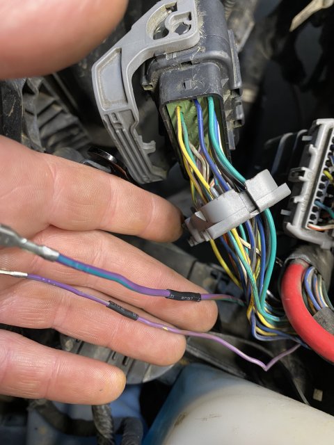

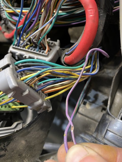

Ok so I took my car to a guy that specializes in fiesta STs near me. They found that the wires going to the IAT sensor were exposed and destroying the MAF sensor. After shrink wrapping the exposed wiring, the P0113 code has gone away! Now it’s just throwing a P051B no description code. After that’s dealt with, the car should be good and clear of CELs.
