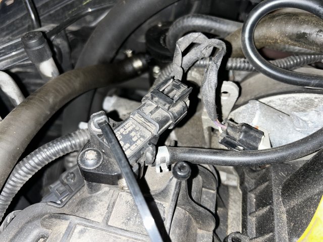

also I thought the MAF sensor was this one?
Nope, that's the MAP sensor (manifold absolute pressure). The MAF (mass airflow) is the one that is taped and also contains the IAT sensor.
oooooh ok, I wonder then if they never replaced it because it doesn’t look very new. Maybe ford just sprayed the old one and told me they put in a new one? Is the MAF simple enough to replace myself do you think?

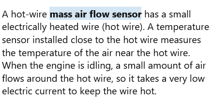

Oil on the IAT sensor doesn't sound normal? The sensor's housing and tube will be just as contaminated and that contamination may quickly spread.
Manufacturers of N/A engines typically use either MAP or MAF but not both. Does the FiST employ MAF in addition to the MAP or is that just IAT? The fact that it's four wire does suggest more than IAT. Prior experiences suggest MAF will be completely useless if contaminated in the slightest. Looking at how your altered intake is routed, may provide clues as to how this is occurring and what needs to be done to truly address this. Are the turbo seals good? PCV in my prior vehicle was routed well downstream of the MAF and IAT so it was impossible for it to contaminate the delicate MAF or skew IAT readings.
