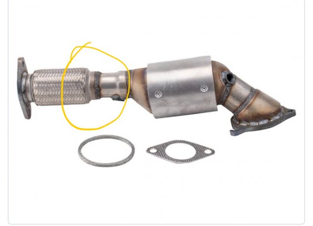

Hey guys I just thought of something. My flex pipe is broken and I think I have an exhaust leak. If there’s an exhaust leak before the downstream O2 sensors, could this possibly be causing the engine code for P0111 or P0113? Car idles rough and pops/bangs a lot.

Get a New Catalytic converter* People are selling their Low mile Cats after High flow and No KiTTY Conversions. Try to get one under 50K for about $100-200* Slightly used.

Alright I’ll give it a shot. Really hoping this is it. When I cold started it in the winter I could see a steady stream of white exhaust smoke puffing out from where the cat converter flex pipe is. If this gets fixed I’m hoping the o2 sensors will maybe read correctly and assign the proper fuel/air mixture? I’m really inexperienced with this stuff though. Does this idea make any sense or is it dumb. I circled the part that is probably broken.

I haven't looked up those codes. Any leak before the upstream sensor is a problem. The downstream, at least with prior vehicles, was only used to monitor performance of the catalytic converter.
