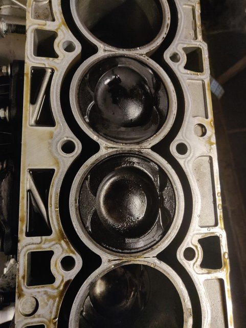

The shims are loose. The length will keep them in place once the head and headgasket is on.
I'm contemplating giving them a tiny bit of oil/coolant resistant gasket to firm up the fit before fitting the head.
Dude those shims look hella loose. Is that normal??? I figured there'd be at least an interference fit because they're supposed to push against the liner to reinforce that area.
How would they even work if there's that much clearance????!
My thoughts excactly but it's to avoid excessive movement and before they look like this:
Remember the block I will install them into is brand new with no warping. A little warping wouldn't hurt the engine as there is tolereances for this excact reason. Everything moves with heatcycles and wear.
