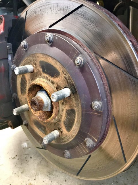

I have roughly 40ish give or take days on this kit now, so far my powdercost is still like new, can take some pics of this next Sunday when I flip the pads for a 15th time LOL the rotors however are 22 days in so far and still look like I can get 3-6 more days out of them (pics below)
The spare parts availablity is a big downside, luckly I’ve only had to order one set of rotors so far (knock on wood lol) and the rest has performed as expected.
That is not to say I haven’t run into a few small issues, but overall for the price compaired to a AP kit for double the money, and being UK based parts would likely be the same issue I’ve been very pleased. With that said I do think a AP kit will be on its way over the offseason to give another product a try! 2851ECD0-CAA6-49BE-A08A-EB32AB43032C.jpeg
