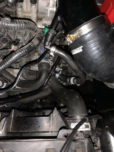

I recently installed a GFB diverted valve and CPE intake to my fist and less than 500 miles down the road I’ve discovered oil in my intake (a fair amount). I have an X47R turbo installed and recently got a tune pushing around 27psi but I do not think that is the cause of the problem. After further inspection I noticed the oil was coming from the crankcase hose connected to the intake from the engine. I pulled my PCV catch can and didn’t notice anything in the oil from normal. I ordered a catch can for the crankcase side but I am a tad worried something is from with the purge line CPE provided and the new intake. Has anyone had any oil coming into their intake before?
What purge line was provided with the intake? Mine did not include this part. Can you post a photo?

It appears my car is having trouble starting now as it seems it is hiccuping from time to time. I did take off the oil cap and have it a sniff and it did smell like I was running a lawnmower. Does anyone have a part number for the pcv check valve? I’m a tad worried at this point because it seems the problem is getting worse even after changing to my low boost tune (8psi)
not off-hand, but dig into the exploded parts diagram here https://parts.ford.com/en.html
I think if you dig around the forum someone's probably posted the part number too.
