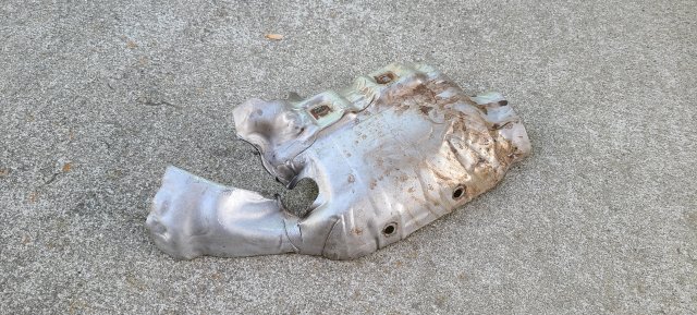

I'd like to see if the OEM downpipe from Ford has the correct label. They have f^cked us so often with shitty parts (think of the heater flap gear). My front pipe has lost the bracket studs so has excess movement, accentuating all of the other various creaks and groans. OK, so they were rusted when I replaced the rear motor mount (2nd time), and I knew they were going to snap off.....
Thank guys for your replies! I still have the oem downpipe and saw no labels on it. Downpipe heat shield also no label. If I put that back on and get it reinspected would they pass it? I think since it was a shiny brand new downpipe that's what triggered the inspector to take a closer look at it. It was a Firestone auto care that I took it to. The tech I spoke to (not the inspector) is an enthusiast in the Subie world so we connected. He gave me his schedule for this weekend and said I could bring it in then and he would reinspect it. <wink wink>
