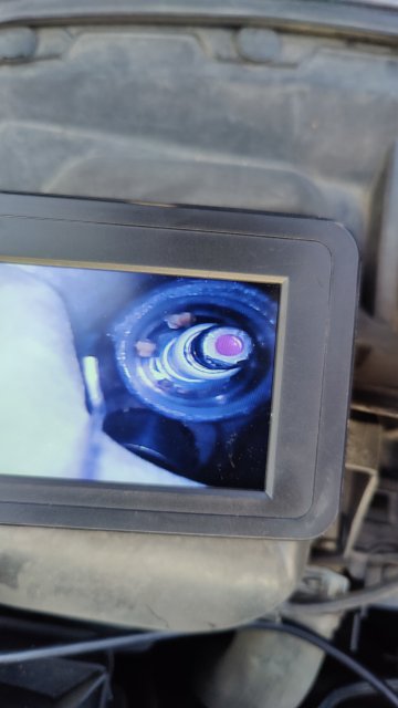

I recently ordered a tune from Dizzy, to prepare for the tune I ordered new plugs. Pretty normal stuff except when I pulled the coil I found a bunch of pebbles sitting in the spark plug well... I tried using air and a vacuum but my current attachments do not penetrate far enough to reach the debris out create enough flow to suck them up..
ANYBODY HAVE ANY IDEAS? obviously I'm not pulling the plugs until I get that debris out.

I am about to buy extra long forceps and something sticky. The pebbles seem to hit the flange of the plug and bounce back down with compressed air... The valve cover shape isn't helping lol

I think part off the issue is my nozzle isn't quite long enough to reach down into the well(story of my life). It's the no. 4 cylinder, the other were easy to remove the gravel... Whoever owned this before must have loved offroading, I don't know how you get rocks under the coils like this

Well I got it out cylinder 4, but they moved to cylinder 3😮‍💨🤣 I ended up doing one at a time as the debris just moved from one cylinder to the next

That's pretty much what I did, blew one out verified no debris and swapped plugs, then on to the next... Time consuming but pretty easy

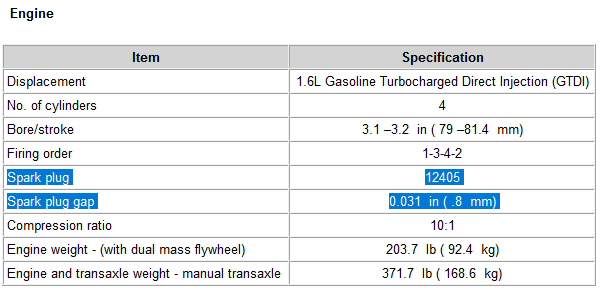

I'm around 80-ish. Engine idles smoooooth. (for a 4-banger) How were the plugs a look'n? What was the gap?
Plugs didn't look terrible little browning on the porcelain with a slightly white electrode, gap was around .036-.040... I agree it idles smooth, even with my RMM
