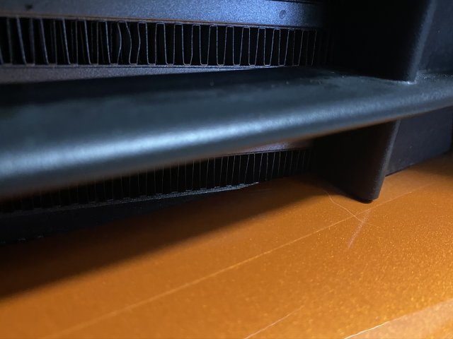

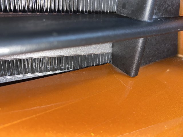

Just installed one yesterday. I did end up shaving a few mm with a dremel from the inside of the bumper on the outermost edges of the grille that covers the FMIC. I probably could have shaved another mm or two, as while it fits, it JUST fits. But it was a very minor mod; even knowing I did it, I can’t tell unless my face is literally inches away from the bumper looking for it.

Awesome thanks for the info. I just finished installing the new boost hoses about an hour ago. When you Say the bumper needed trimming, is it the actual bumper or the lower grille? I’m about 85% on just pulling the lower grille. I like the open look but it would provide at tad more protection for the IC. So if it’s shave it or remove I’ll probably just remove.

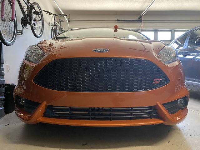

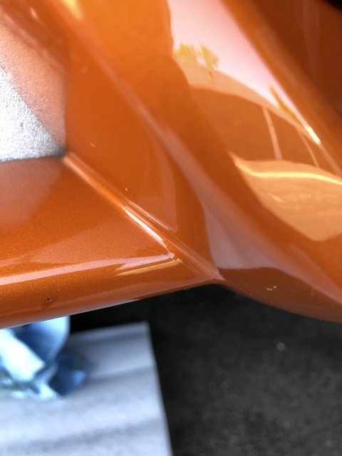

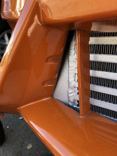

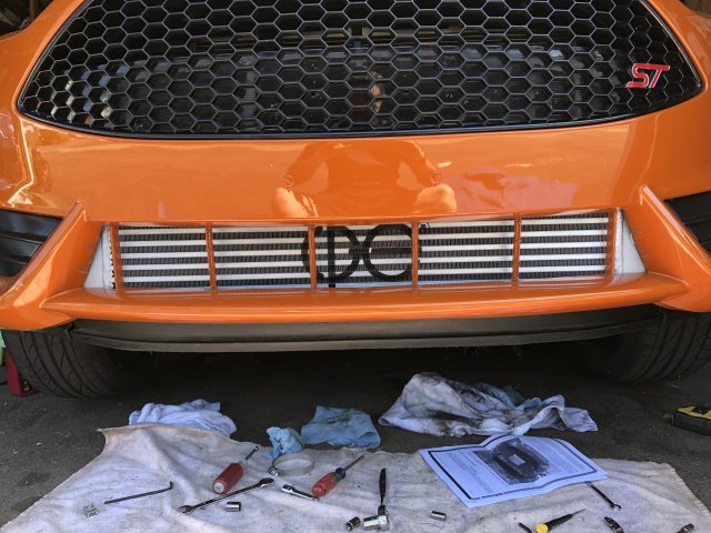

I shaved both, namely where the grille clips into the bumper. I didn't go completely through the clip, but I'm sure I weakened it some. Even so, there's enough intact clips that I'm not worried about anything coming undone.
I wish I took pics of the bumper interior when I did it. But here's a few of the finished work.
I like the stealth look:
You can see it better if I get level with it:
This is a close-up of where I shaved the driver side. You can't really tell that I did anything, even this close.
And with the flash on. It looks like I trimmed a lot, but I really didn't. From the bottom of the grille to the top, it flares out a bit, so no need to trim above the bottom-most grille.
Hope this helps!

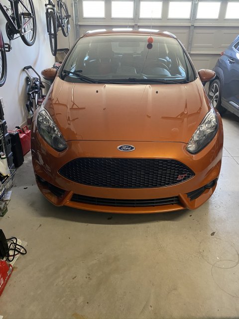

Done and done! The bumper is decidedly in contact with the end tanks on the IC but CPE instructions noted some contact is ok and it didn’t cause any of the bumper mounting points to be off or a stretch to line up. So the only shaving I had to do was the center air dam mounting piece noted above.

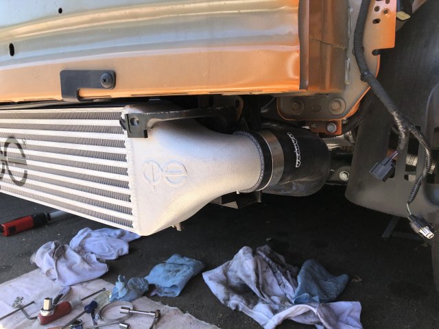

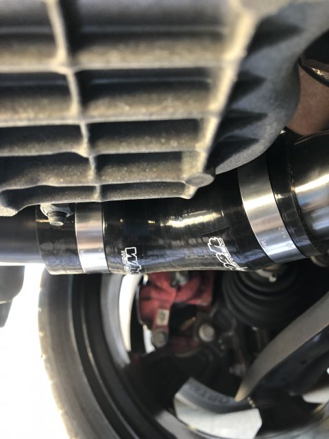

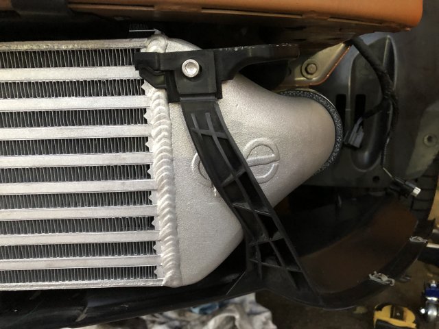

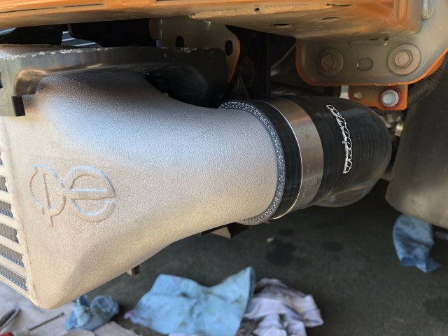

Well, of course I didn’t take any pics of the front of the car with the stock IC still on (or off) but here is one from the side and underneath after mounting the CPE. It’s the center of the 3 lower bolt locations that the air damn bolts to. Which itself bolts to the radiator support surround (or whatever that’s called).
#11243
440
414
And it was a bit of a pain getting that thing in there. I loosely bolted the mount in place then I had to tape a piece of cardboard over that area of the back side of the IC to prevent messing up the fins, and use a thin open end wrench up and over the top of the IC then down the back side to tighten the bolt up for the mount. I could have chopped more of it off but I wanted it to rest up against the bottom of the IC as I believe that’s how it is with the stock IC.

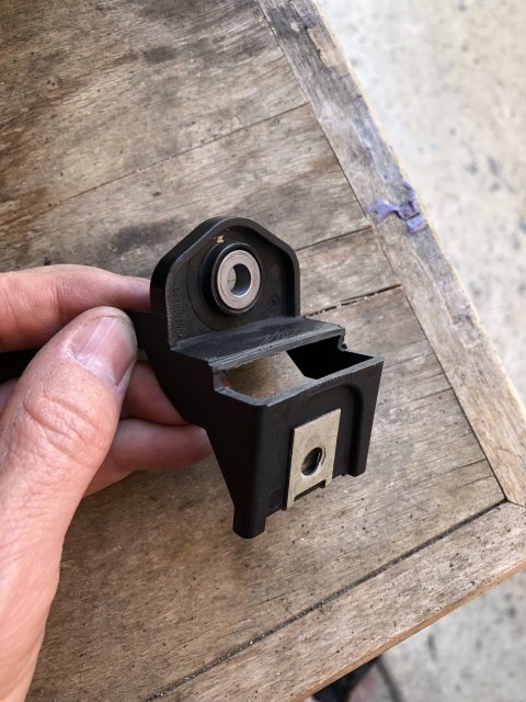

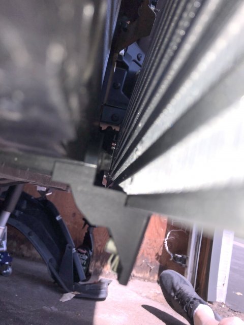

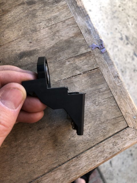

I looked through my pics closer and found one showing the mount I had to notch. It’s the center one below the IC. And you can obviously see the other 2 for reference.
#10469
8
8
Awesome! I like how the notch that you cut out provides a bit of extra support. I think I may end up doing the same this weekend.
